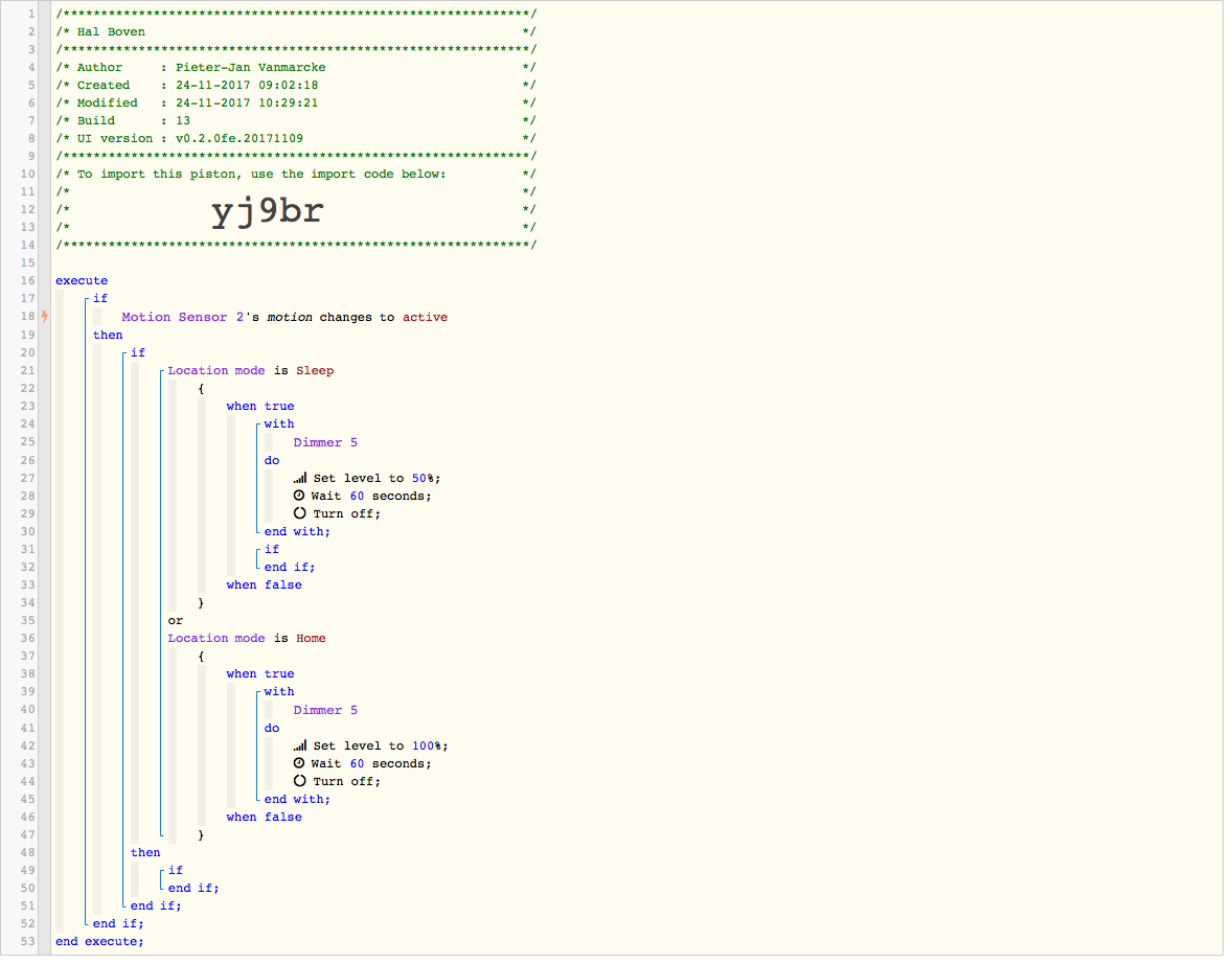

Hi,
I’m still having trouble with pistons including motion :frowning:
I created this piston which works if I set the timing for 10 seconds, but if I change the wait time to 1 or 2 minutes, it doesn’t.
Any idea what’s causing the troubles?
Actually I wanted to make a piston that:
When motion gets detected: puts on the lights at 50% while in sleepmode and at 100% while in homemode. In the best case, the lights should turn off 1 minute after motion has ended, unless there’s new motion in the “wait” time.
Tnx!

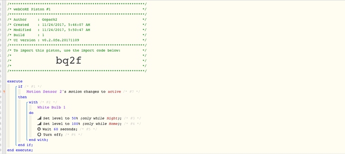

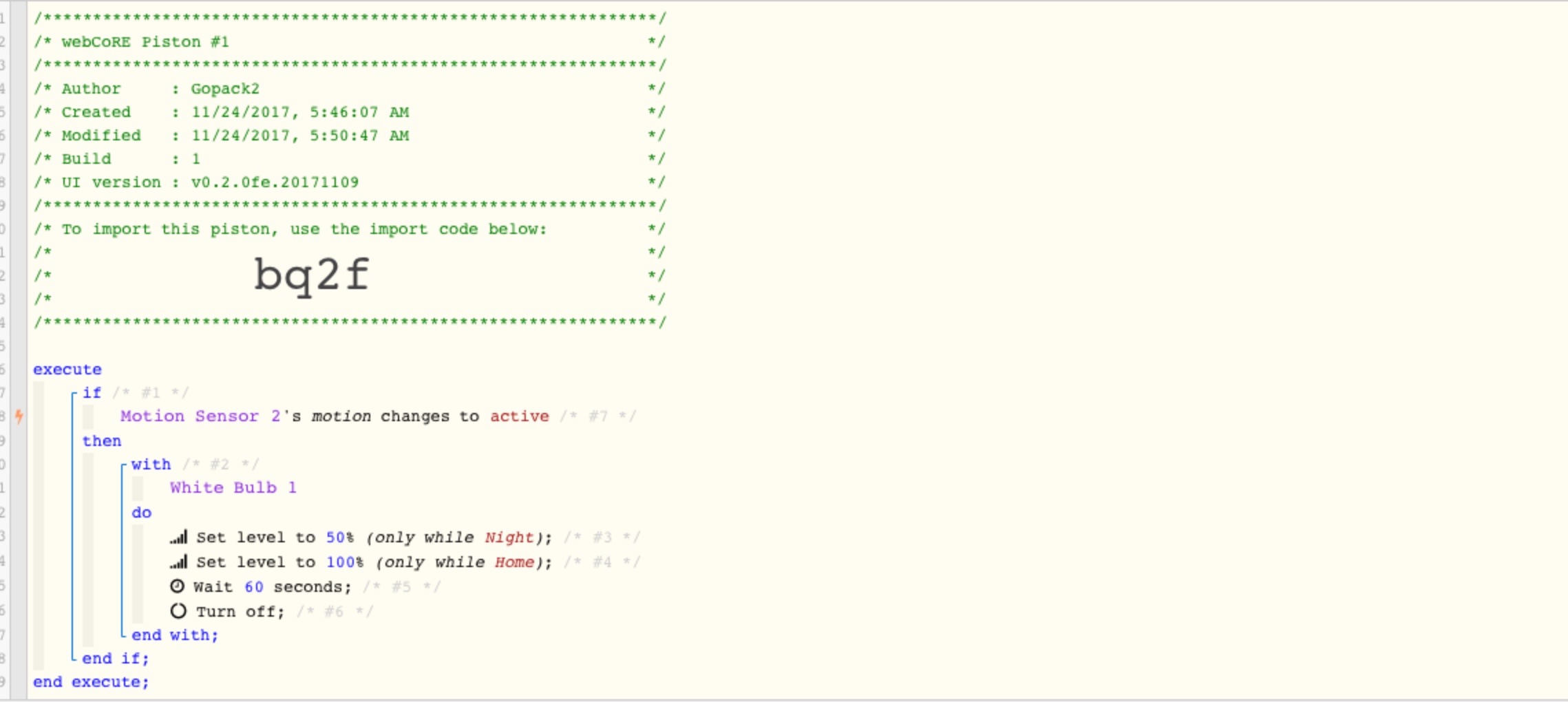

How bout this?
Does it work if you change TCP to Never?
https://wiki.webcore.co/Task_Cancellation_Policy
The one I shared works without cancelation and is not using nested ifs. Just an fyi
it will work without TCP if the motion sensor has a longer than 60 second timeout. otherwise it will not work without TCP.
Tnx for the replies :slight_smile: I’ll give it a try soon. Busy at work right now :slight_smile:
Where can I find the TCP options?
Good point. Lol my sensors time out at 4 mins.
Found the TCP settings :slight_smile: I will have to test what gives the best results …
