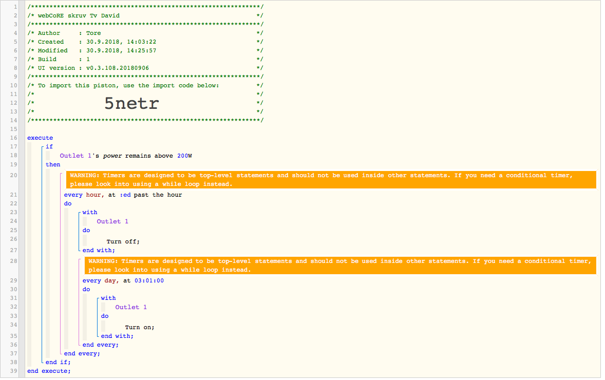

If the plug reports power draw you can start a timer in webcore for 1 hour when it reaches the threshold. I know the centralite ZigBee’s report power draw:
RonV42
The warning message says it all. The best way of doing this is with a for loop:
If power above xxx
For x = 1 to 60
wait 1 minute
NextTurn power off
If power below xxx
cancel events
