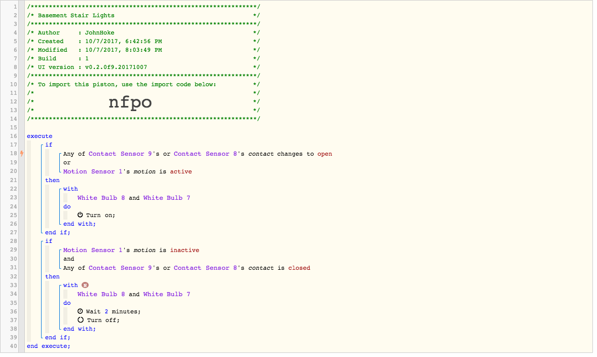

So here we go with what I ended up with … made a bit of a tweak - the light stays on until both doors are closed and motion stops for 2m
@bangali Thanks again for helping my mental (case) block!
sure thing. only thing i would recommend is change the first changes to to is
otherwise you are mixing conditions and triggers and this piston under certain conditions will not do what you expect it to. :slight_smile:
