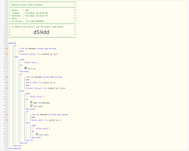

I cannot get the piston to function correctly for anything past the first if statement. No issue turning on the light switch when door status is open. All other if statements not working. I did try Execution method change from Synchronous to ASynchronous but did not fix. Any help would be appreciated.
During sunset-sunrise I want the light switch controlled by door sensor. When door opens lights turn on. After 10min of door closed want lights to turn off. During the day I want light to remain off even if manually pushed.
Cannot get piston to work past 1st if statement. Lights will turn on but never turn off according to other if statements

I would do it differently.
IF
Time between
and
Contact is open
THEN
WITH
Light
DO
Turn on.
ELSE
WITH (Set TCP to never).
Light
DO
Wait 10 min.
Turn Off.
Would that do the job for you?
Thank you for the help. This worked.
