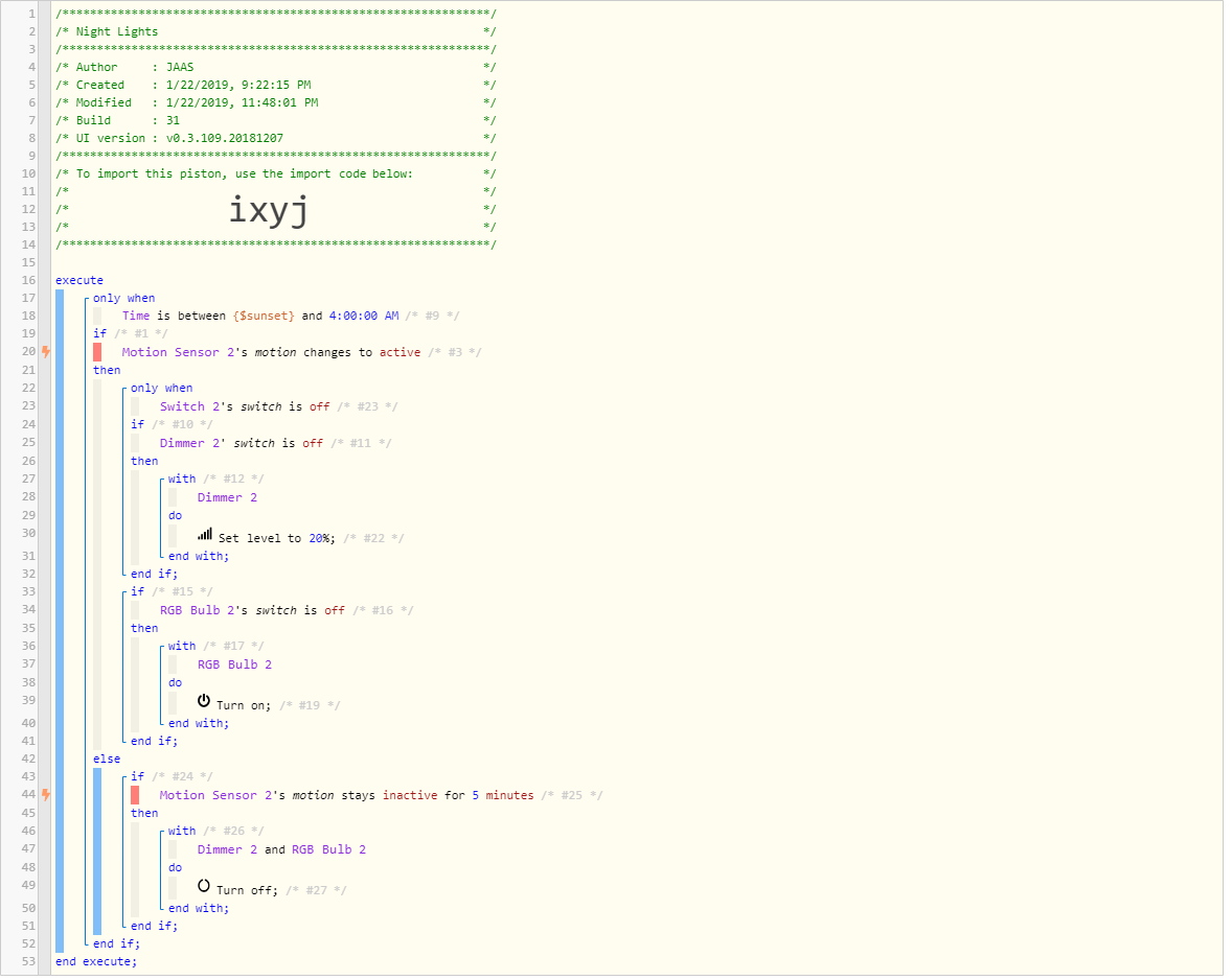

Turn on/off lights based on motion.. stumped
Need to turn on two lights when theres motion on one sensor. Nothing should happen if the lights are already turned or if the TV is on.
I’ve handled all those conditions. Lights turn on when they should and they obey rules regarding swtich being on and TV being on.
The real problem I’m having is turning them off. I need for both of them to be turned off if there hasn’t been any motion in X minutes.
Lights should turn on with motion (WORKS)
Lights should do nothing if the switch is already on or if the TV is on (WORKING)
Lights should both turn off when there’s no motion in X minutes (NOT WORKING)

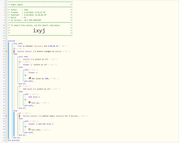

Can’t find the logic required for the lights to turn on after X minutes. I’ve tried multiple variations of “stays off for x minutes” and adding “wait for x minutes” before the off command.
I’m pretty sure I know what’s going on but can’t find a way to prevent it. Currently I have it so once the motion detector motion changes to inactive to turn them off after waiting 5 minutes. My guess is that once that 5 minutes timer starts it keeps counting down even though motion is detected again. Thus if you leave the area for 30 seconds (time it takes for the sensor to go back to inactive) then return (sensor changes to active) the light still turns off after a while.
I really love the idea of webcore and the potential behind it but its really frustrating for me. I keep coming with piston ideas that in my mind seem very straight forward but then I turn them into a mess when trying them out; there’s always something that won’t work as expected that I never thought off
Lines 43-51 should be outside the ELSE.

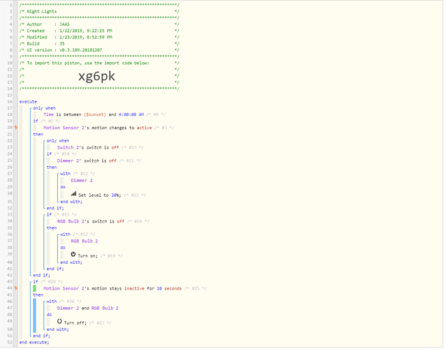

HI @JAAS666
I believe it’s very simple…
instead of ELSE
use that as a second IF
Delete everything you have with ELSE
and add them outside of your first IF (not in)
IF motion sensor changes to active
do this do that (everything you have until line #42
LINE #43 or what ever is next should be :
IF motion sensor 2 motion stays inactive for 5 minutes
With dimmer 2 and RGB bulb 2
Do
Turn OFF
that’s it you are good to go…
hahahahahah did we post this at the same exact time LOL
Beat you by two seconds, LOL
The logic behind this @JAAS666 is an IF Trigger inside an IF Trigger will never fire
Because you wrote it shorter…
umpire, I want to challange this… let’s watch the video pls.
One of the few times my response was short…
Oh yea I totally missed that. It is in fact inside the first if. Wow that was a quick response.

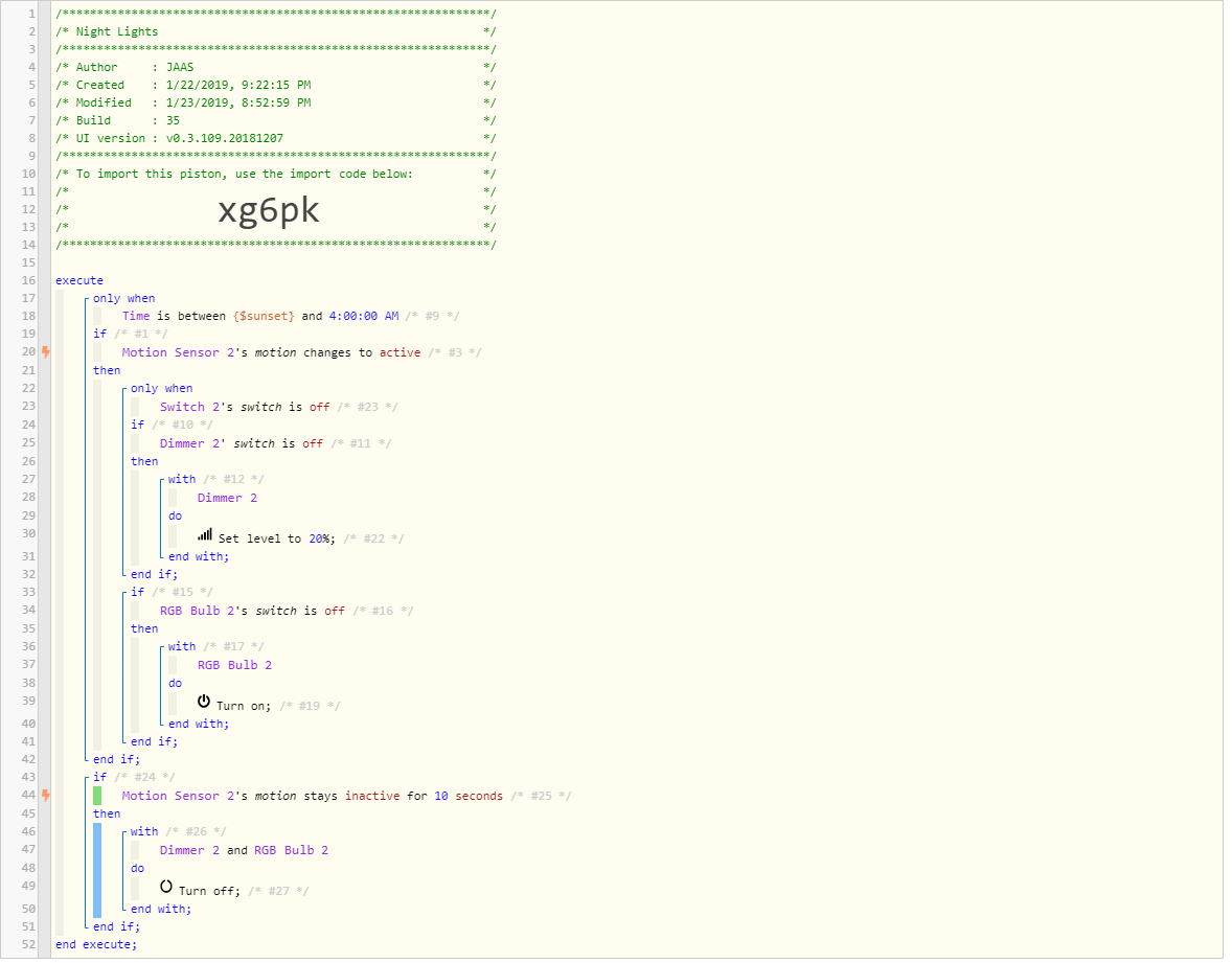

I tried it now and the timing is working correctly and it does get cancelled If I go back to the room… but something I’ve noticed now is that both lights WON’T turn off at the same time.
Here’s what I have now. Dimmer2 is turning off and about 5 seconds after that then the RGB turns OFF.
