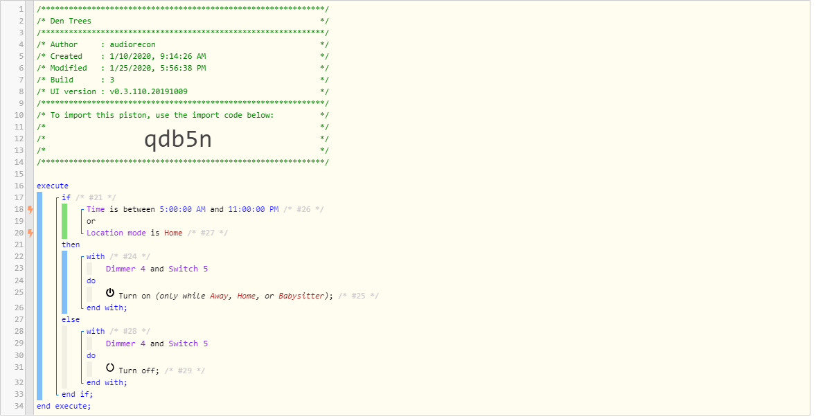

Turn on/off plugs when home and between times
Plugs always stay on
They should turn off when not home or between times.
They always stay on
could it be the OR you used in your IF section? If you are Home between 11pm and 5 am then I can see why they are on 24 hours. You may want to use “and” instead of “or”.

As I understand it, your original piston will fire under three conditions: 5 AM, 11PM or when the location mode changes. Only way for the lights to go off using this piston is for the location mode to change lawny from Home between 11PM and 5AM which is not likely so the lights will stay on all the time as you are seeing.

Looking at the original piston, the plugs should turn on at 5am regardless (5am is considered as between the two times). Anything the location mode does between 5am and 11pm will not make any difference. At 11pm (which is not considered as being between 5am and 11pm), and whenever the location mode changes between 11pm and 5am, the plugs should turn on or off depending on the location mode at the time.
So if the lights are staying on all the time, that would suggest that the location mode is already set to home at 11pm and all night and @jkp may have correctly identified the intended behaviour and the solution.
It was the “and” not “or” that was the issue thanks
