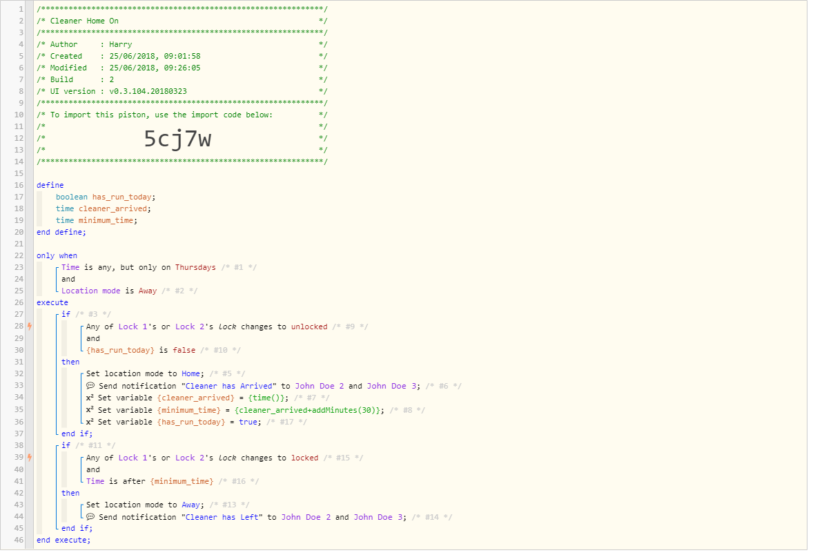

Home/away mode is usually controlled by my/my girlfriends phone location. I want the house to go to Home Mode when a cleaner comes (but without monitoring her phone location). I have smart locks back and front, so I thought I could use that (as she has a fob).
When the front door is unlocked, only on a Thursday, the house will go to home mode. She will probably lock the door behind her, and then leave two hours later. When she leaves, I want the house to go to away mode.
I’m interested to see if you think it will work. I’ve not used addminutes before etc.
Not yet run.
