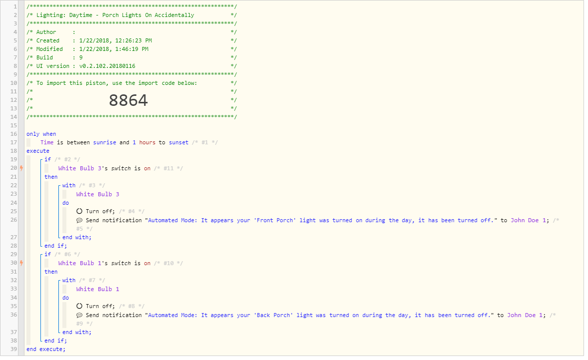

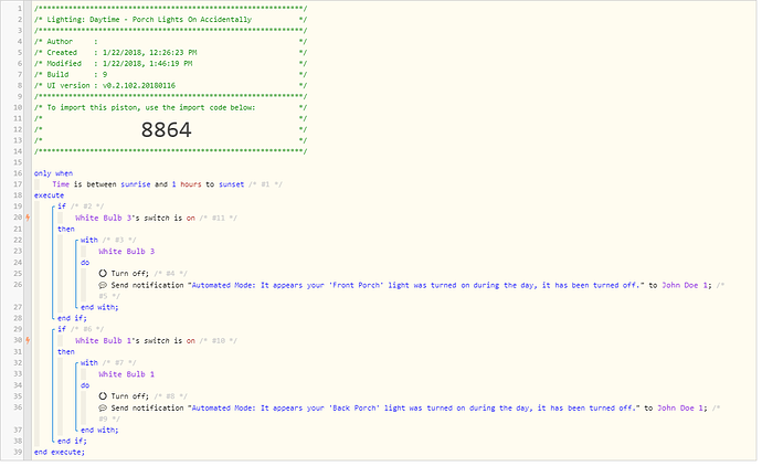

Accomplish:
Turn off either porch light if they somehow go on during the day.
Issue:
The issue is that if I turn “White Bulb 1” on…it looks like the piston is firing twice and I receive the notification for “White Bulb 1” twice.
I’m not sure why this is happening other than (it could be?) “rule #20” is being triggered…evaluating to false…and continuing the script.
I’m not sure if that’s the case or not…but it also brings up the question of how do I efficiently run this script…to really only trigger it if the condition of:
  1. Between sunrise and sunset
  2. Switch turns on
  3. Don’t run the script otherwise
The other thought I had was to break this up into two separate pistons, but that seems inefficient too.
Just need some help here (still new to this) and trying to understand the architectural ins and out of this. I realize I may need another approach as well and I’m open to that. Thanks!
Can you post a log of it firing twice?
One thing you can do quickly is change your IF conditions from “is on” to “changes to on”. That’s less likely to generate duplicate messages. But either way, turn on full logging and trip the piston to reveal what’s really happening.

Looks like ST received two on notifications and one off with 1 second. Your piston would have notified you of each of the On conditions.

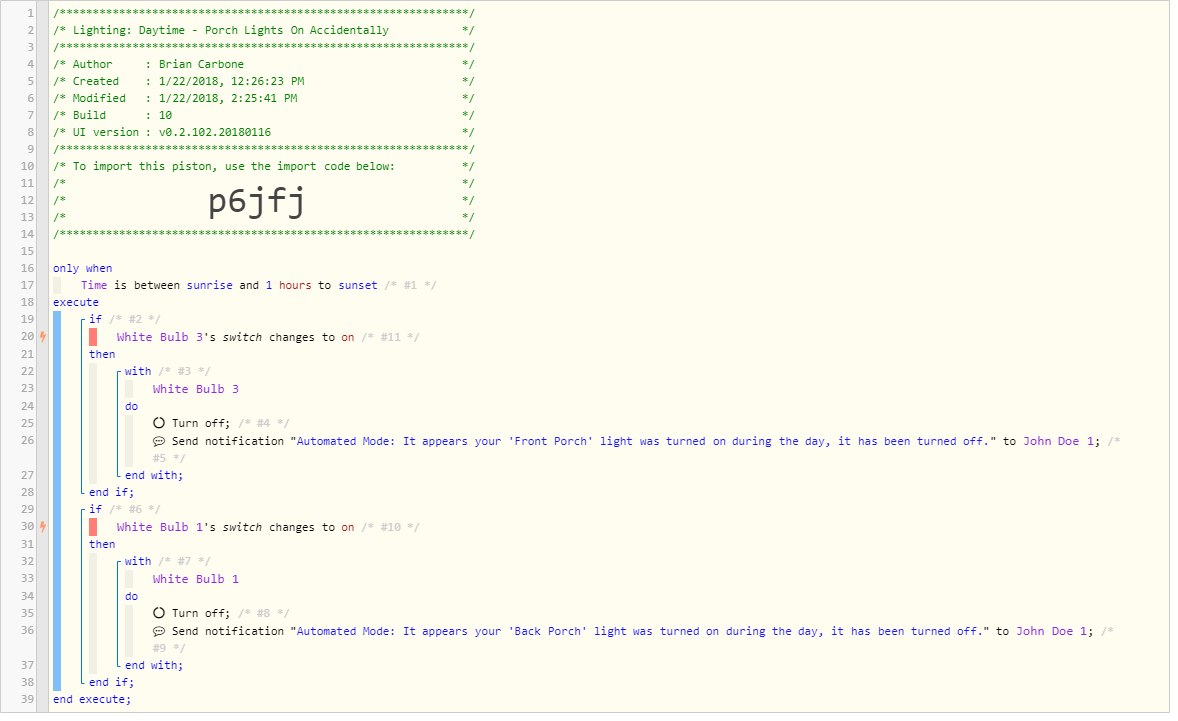

Try changing your piston to “switch changes to on” instead of “is on” and see if that resolves it? Otherwise will need to see more logs to understand what’s going on so we can fix it.
I tried “changes to on” and get two notifications when I try to turn on “White Bulb 1”
