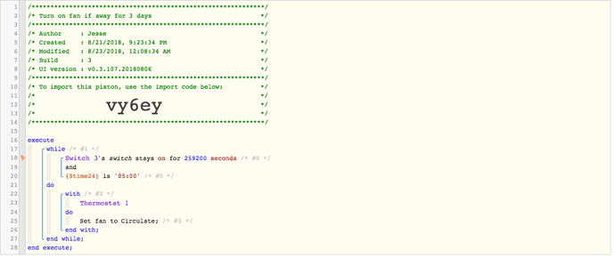

I am very new to Core. Honestly i’ve been trying to get into for a while but it seems pretty advanced for me so thanks in advance for any guidance. I would like my NEST to turn on the fan at a set time after my house has been vacant for an extended period of time (I chose 3 days at 5am). I have a virtual switch turns on when ST runs the “good bye” automation. I already use in some IFTTT rules so I’m reusing it to trigger the piston. I think my rule will work (I just have to leave for 3 days to test it out). The one thing I’m not sure of is how to make it run again on the 6th day, the 9th day, etc.

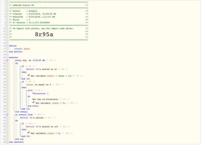

try something like this:
