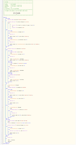

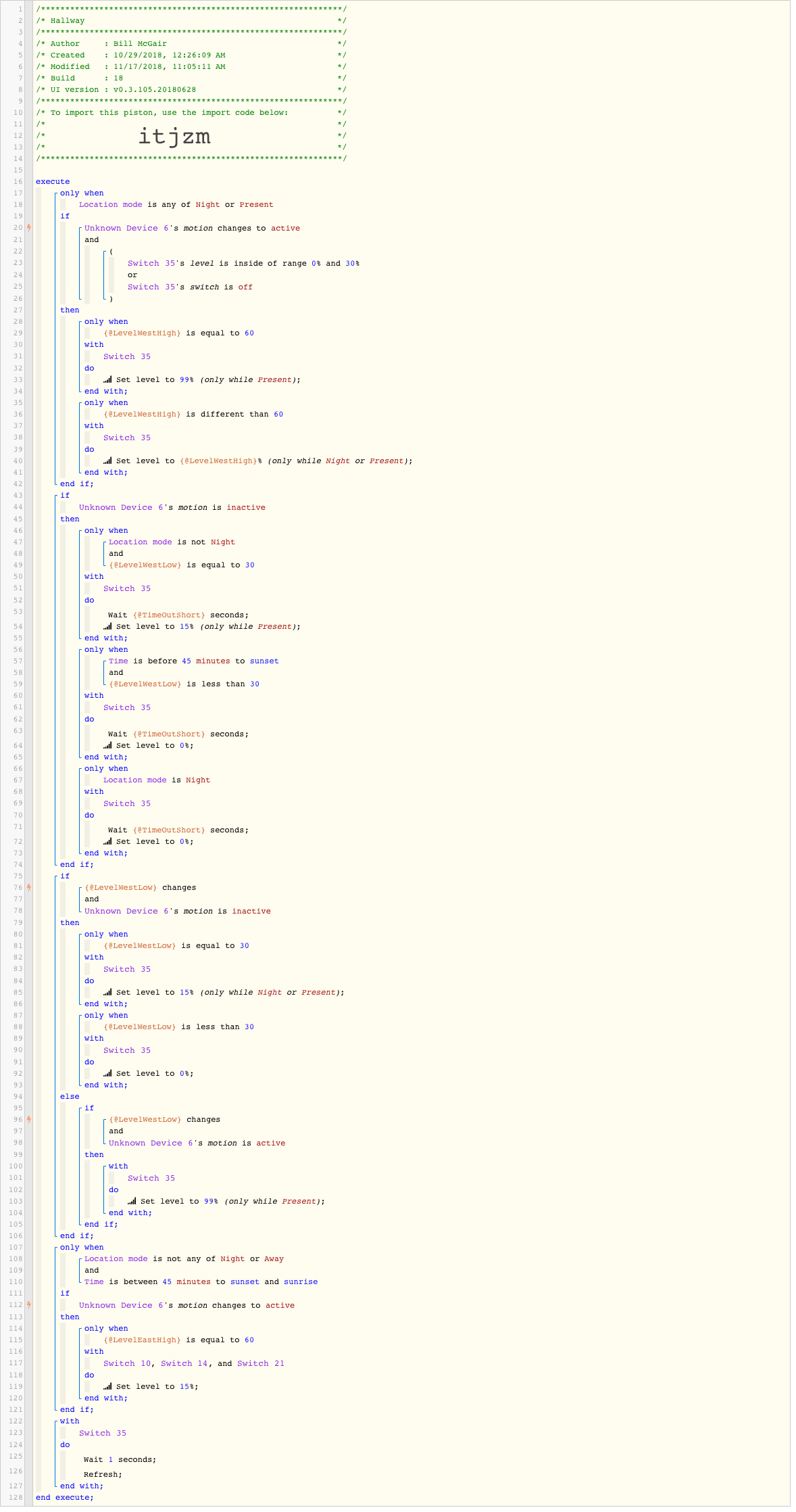

OK well here’s a piston that doesn’t make use of this particular global, @LevelEastHigh.
None the less it receives an event when @LevelEastHigh is updated and executes the piston as you can see from the logs. This event also seems to be either cancelling my condition, or causing my pre-existing wait timer to reset. This seems really wrong. How can I prevent my piston from executing when a completely un-related global var is updated? I still need it to be global because it’s used by two other pistons, just not THIS piston.

I do not code like this, but I believe you can change lines 111-121 to this:
IF
    Unknown Device 6's motion changes to active  <-- Trigger
    IF
        @LevelEastHigh is equal to 60            <-- Condition
        With Switch 10, 14 & 21
        Set level to 15%
    END IF
END IF
Notice one IF is inside the other. The outer IF is the trigger, and the inner is a condition. This block should not look at the global unless Device6 changes to active.
Yep just saw that too. It’s not supposed to be using @LevelEastHigh, that’s the wrong var and explains why its subscribing when it shouldn’t be. Thx.
As for using a condition inside a trigger… that seems logically consistent, but I suppose I figure the restrictions are there for a reason so I’m going to make use of them.
