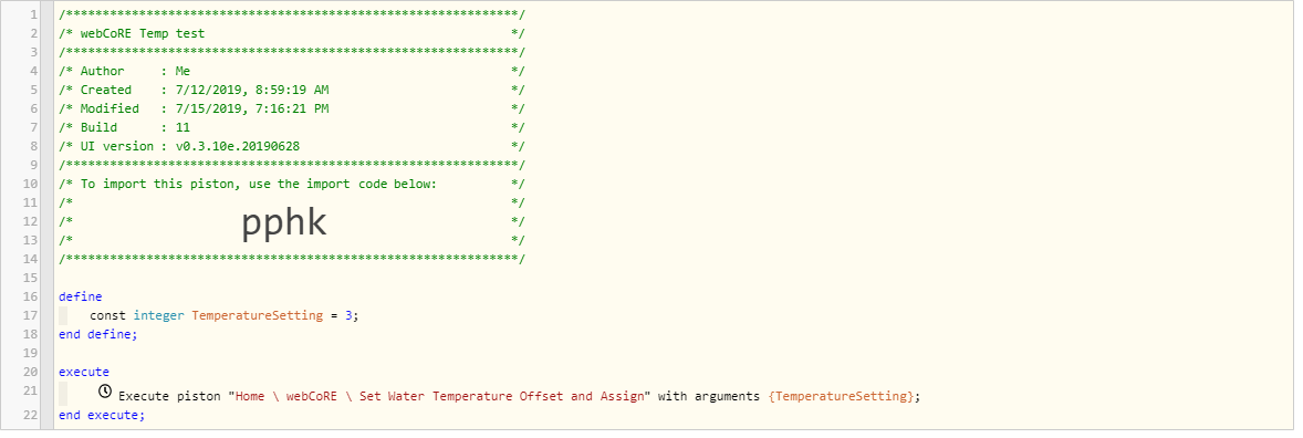

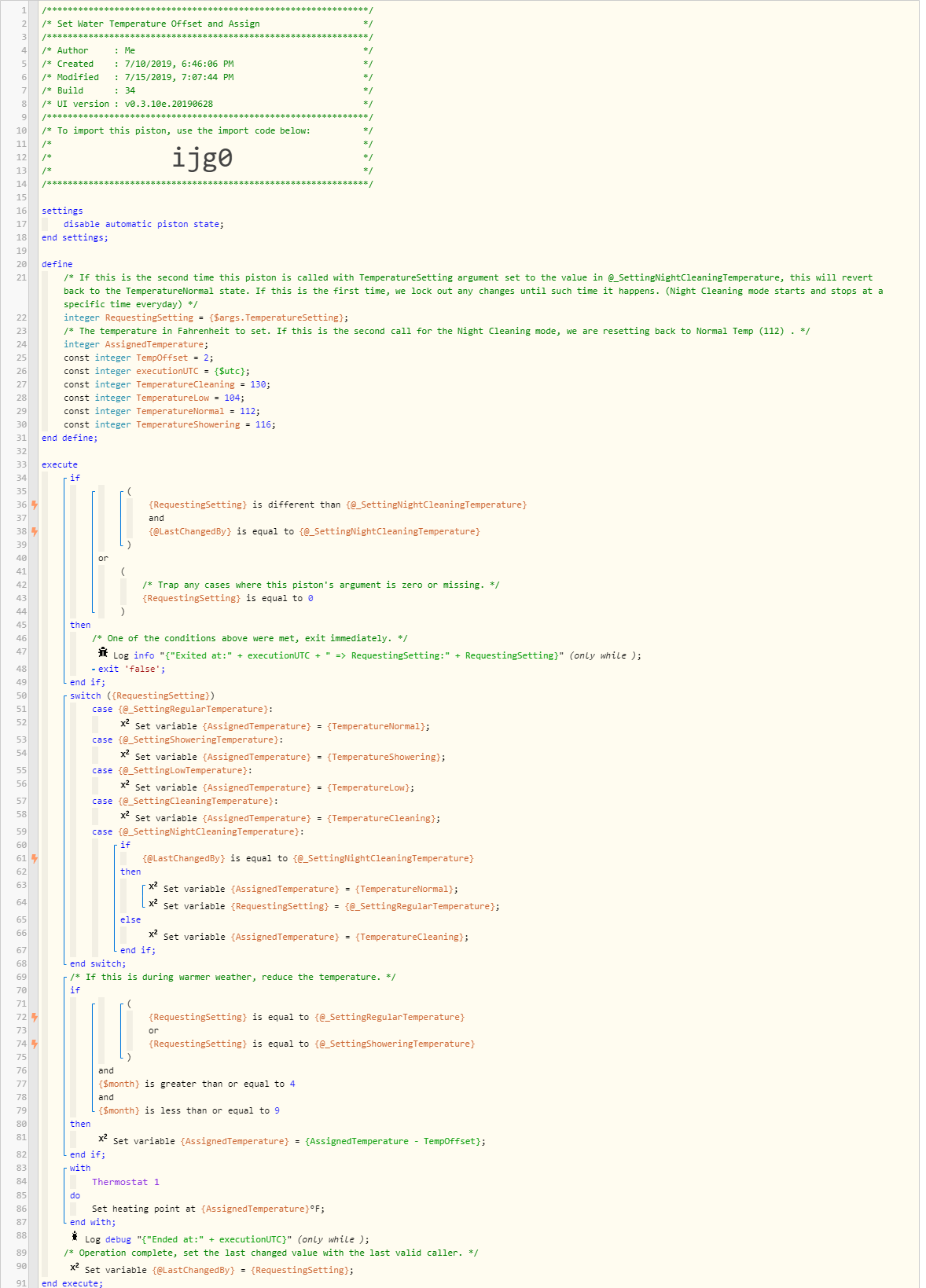

Executing a child piston happens multiple times on the same call (it is not in a loop, using a callback or recursion [in other words it does not call itself directly or indirectly]). The logs below show it happening twice but in some cases SmartThings reports three times.
The instruction to call a piston happens only once.
A call made by a parent is happening multiple times (should be only once) on the same child piston. The “unwanted calls” have an argument value that is 0 (an integer type in my case) and it is easy to trap and exit the piston. I should not have to handle this condition.

I use a $ as a replacement in this post to denote an at symbol (followed by an underscore) as global variable that is a “constant”. I won’t let me use the at symbol for any reason, since it thinks I am adding users to a post. Because there are not global constants, I use this markup to tell me the variable should not be modified in a statement.
_Additional variable values _
integer $SettingCleaningTemperature = 4;
integer $SettingLowTemperature = 1;
integer $SettingNightCleaningTemperature = 5;
integer $SettingRegularTemperature = 2;
integer $SettingShoweringTemperature = 3;
