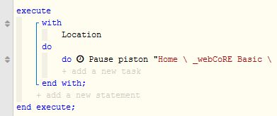

The way that I do that is this. First, make a new piston called something like “Pause X Piston” and make the code this:
but point the red text to the piston that you wish to pause…
After you save that piston, look at the top of the piston page, and take note of the highlighted section here:
Take note of the External URL, and then you can run that piston
(which pauses the other piston) with a simple click.
