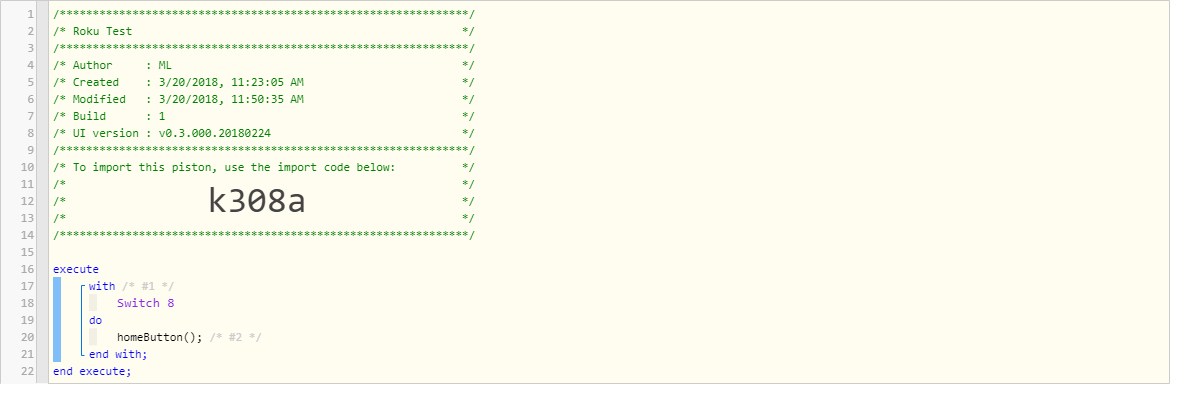

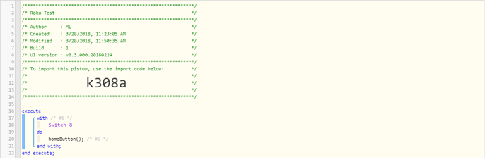

I’m not sure how to write a piston that will execute the necessary commands. I created a simple piston that successfully executes the “Home” command but don’t know what parameters to use for other functions.
This is as far as I’ve been able to get:

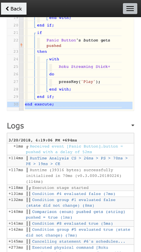

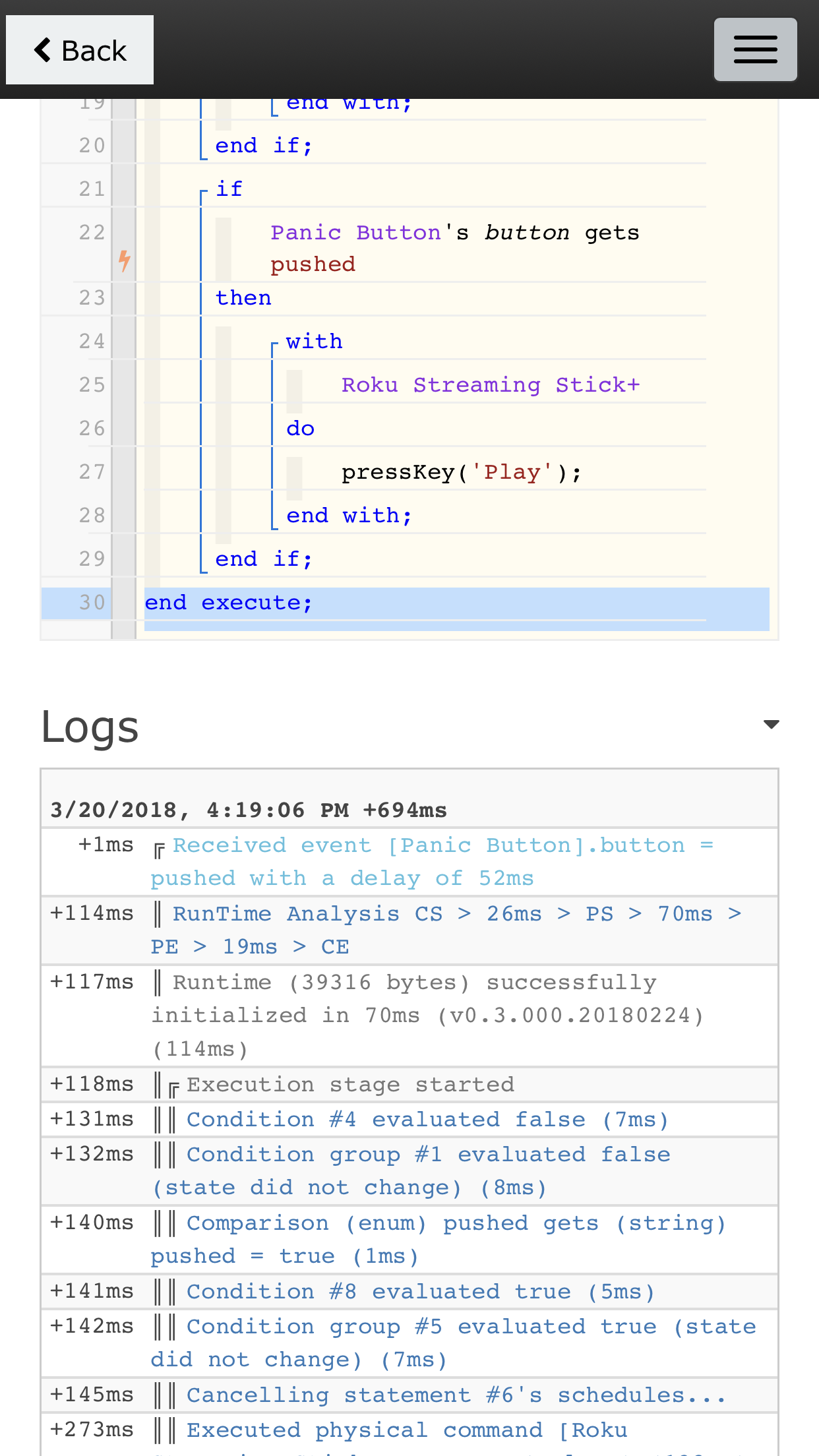

Here’s what you’ll want to use - just checked it out and works fine for me.
Thank you. I’ve managed to get the play/pause feature working using pressKey(‘Play’) but it appears there is no way to adjust the volume or mute the audio.
There are some audio commands listed in the developer documentation, so I’m not sure if my device doesn’t support them or I’m doing something wrong but none of them work.
