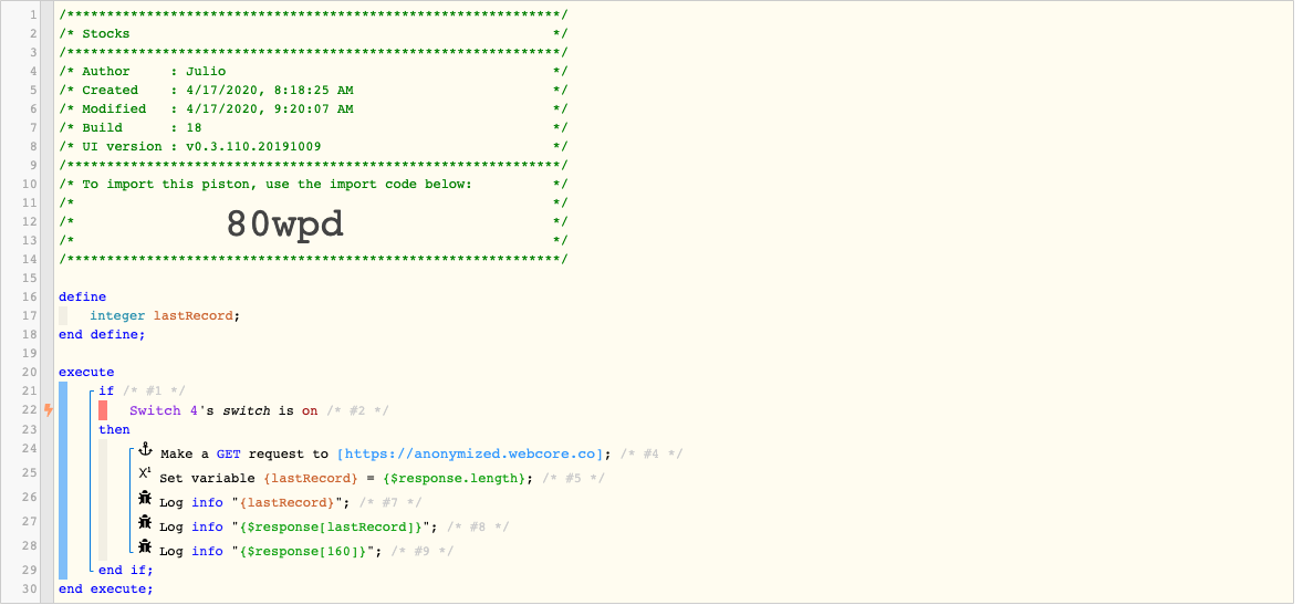

I’m making a request for a JSON. It changes every minute and the record I want is always at the end. I can’t get a variable to work when writing the expression.
I’m taking the length of the array to get the last value:
set variable lastRecord = $response.length
from there, I’m just trying to get the last record, but it’s not coming though.
$response[lastRecord]
$response[lastRecord] is retuning NULL
$response[160] returns the value, but I need the latest as it refreshes every minute

Without seeing what $response variable contains… try logging the value of $response.lastRecord
That just comes back NULL, as there is no object in the array called lastRecord.
the lastRecord variable is a number for looking at a specific object in the array (the last one to be exact).
This is what the JSON returns:

Does what I’m trying to do make sense?
I’m just trying to get the last record, but that one is constantly being appended to the dataset.
This gives you the number of records but they are numbered 0-(length-1). Try subtracting 1 and look at that record.
Can you log $response and show us what it contains?
So simple, this did it!
Thank you!
Good catch, @guxdude!
