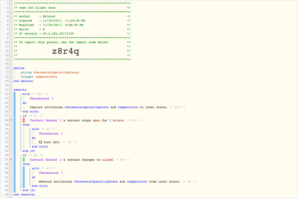

Using Capture & Restore with T-Stat Attributes

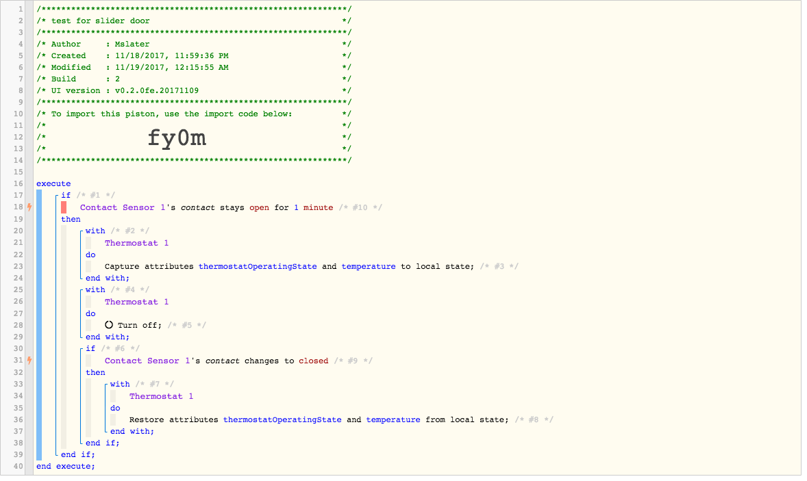

I want my T-Stat to shut off the A/C when my patio door is open > 1 minute. When the door gets closed, I need the T-Stat to come back on to same settings it was set to when it went off. Using Capture & Restore for attributes seems like it should work.
See above
T-Stat goes to OFF as it should. It doesn’t turn back on as it should. Probably because of where I put the nested IF statement(??)

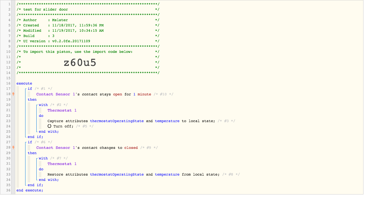

Can’t nest triggers. The door can not be open for 1 minute and closed at the same time. Pull that nested if statement out and set it below your first if statement.
Also you don’t need 2 with statements for your actions. You can just add the turn off to the first with action
Thanks @c1arkbar… is this what you meant? But my concern here was with the syntax of “stays open” and “changes to closed”. Am I ok with these? Thanks again!
EDIT- Tried… this turned the tstat off as it should but did not turn it back on.
That is what I was talking about. Do you have any logs for when this? Might find out why it’s not turning off
I have ‘trace’ running and logging set to FULL. How do I capture the logs to post them… just copy/paste? I see there may be a problem with the catured data
51 PM
instead of using the baked in version you might just need to set your own variables and then use those to restore from.
I think I realized that I needed to change the order of operations becaise if the door was closed, it wouldn’t ever capture the tstat’s attributes. So I changed it to this, but still not working. Oh, I also thought maybe I needed to define the variables so I tried temperature as an integer and thermostatOperatingState as text.

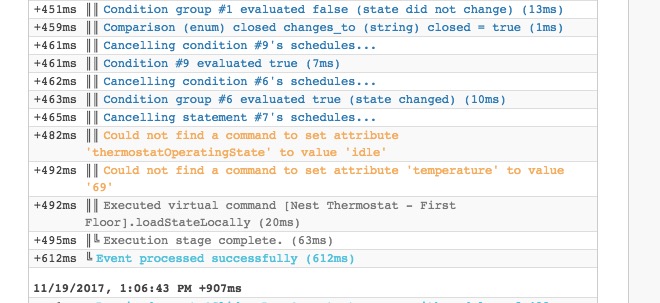

Logs (I put some error lines in bold:
11/19/2017, 10:00:26 PM +38ms
+1ms ╔Received event [Slider Door].contact = closed with a delay of 320ms
+93ms ║RunTime Analysis CS > 13ms > PS > 45ms > PE > 36ms > CE
+229ms ║Runtime (37949 bytes) successfully initialized in 45ms (v0.2.0fe.20171109) (226ms)
+230ms ║╔Execution stage started
+235ms ║║Cancelling statement #11’s schedules…
+248ms ║║Executed virtual command [Nest Thermostat - First Floor].saveStateLocally (6ms)
+257ms ║║Comparison (enum) closed stays (string) open = false (2ms)
+259ms ║║Cancelling any timed trigger schedules for condition 10
+260ms ║║Cancelling statement #10’s schedules…
+261ms ║║Condition #10 evaluated false (10ms)
+262ms ║║Condition group #1 evaluated false (state did not change) (11ms)
+269ms ║║Comparison (enum) closed changes_to (string) closed = true (1ms)
+271ms ║║Cancelling condition #9’s schedules…
+271ms ║║Condition #9 evaluated true (7ms)
+272ms ║║Cancelling condition #6’s schedules…
+273ms ║║Condition group #6 evaluated true (state changed) (9ms)
+275ms ║║Cancelling statement #7’s schedules…
+289ms ║║Could not find a command to set attribute ‘thermostatOperatingState’ to value ‘idle’
+299ms ║║Could not find a command to set attribute ‘temperature’ to value ‘71’
+300ms ║║Executed virtual command [Nest Thermostat - First Floor].loadStateLocally (20ms)
+302ms ║╚Execution stage complete. (73ms)
+312ms ╚Event processed successfully (312ms)

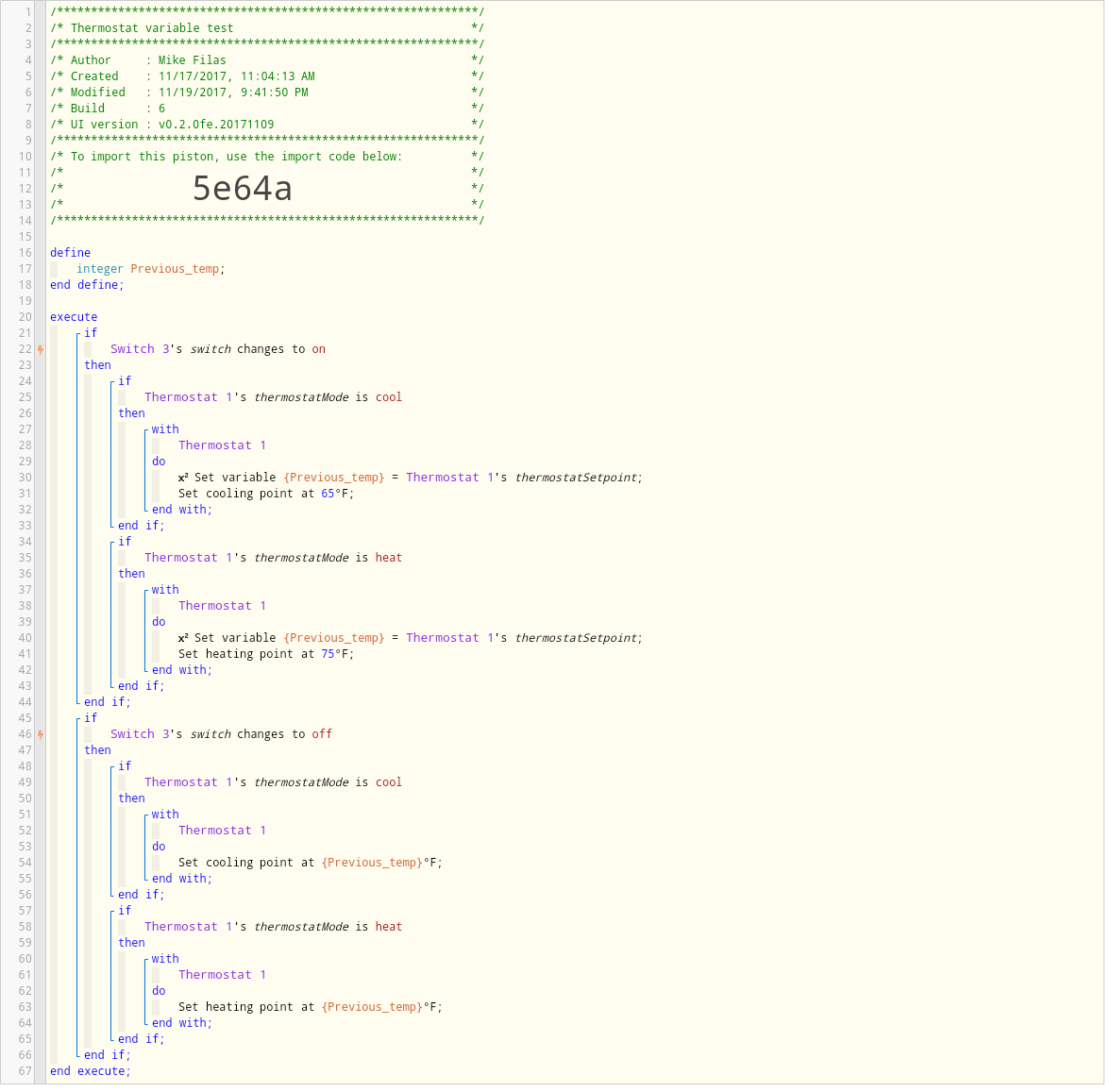

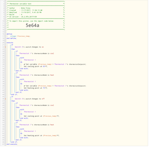

Is this in line with the other thread I am commenting in with this exact same issue?
Do not use the baked in capture and restore. Instead use regular variables
:grinning: Your other reply is above. The problem with regular variables is that… let’s say I set it up now- I’d ask for ‘heat’ mode and 71F. But when the weather changes, so would the mode and temps needed. It wouldn’t be a valuable piston if it needed a stock set of attributes (mode and temp). But ok, if capture and restore can’t be used- what other way can I get the tstat to come back on to same mode/temp it was at when it turned off?
LOL- Now I see what you mean… No, there’s MY thread, plus another on identical topic by @Mightybuffalo2000
Looks like we’re both trying to capture & restore. This is really the best way to accomplish what we are trying to do.
I did it. I figured it out about an hour ago.
And here’s another example
#15

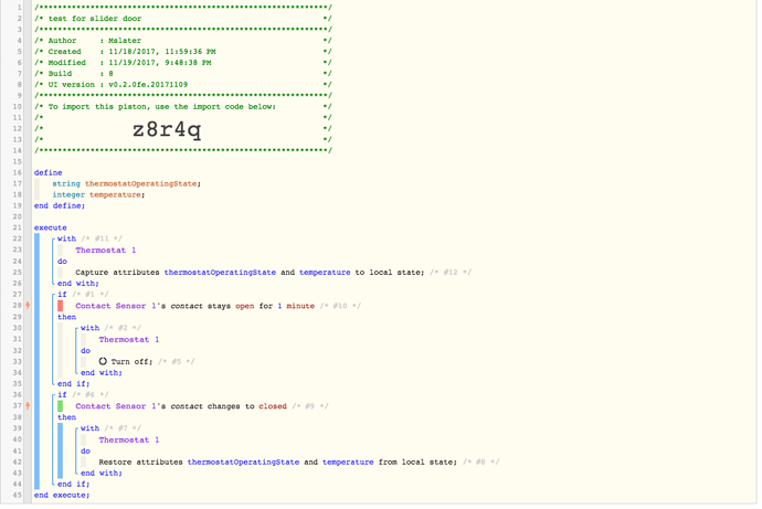

u5fjc: Seems like you’d want to flip lines 27 and 28… no?
#16
You are right. Here is the latest one I made for someone.
#17
This is what I was talking about. You are still setting them not making them defined.
