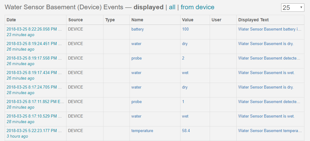

Here are the events when probe 1 and probe 2 sense water.
I don’t know how to translate what I’m seeing in the Device Handler and Event Log into something I can use in my piston. I also don’t understand why my Aeotec nano switch (which controls 2 switches) shows 2 separate child device switches but the water sensor does not show separate child devices for the probes. I assume that is a function of the device handler, but perhaps it’s more so the nature of the device itself?
I believe I have to dive into device attributes to solve my problem. I’m a little concerned however that Probe 1 and Probe 2 did not individually report “dry”. In the configuration I would like to make work, Probe 1 would normally be “wet” and Probe 2 “dry” and any change would be reported. Any insight is appreciated.
