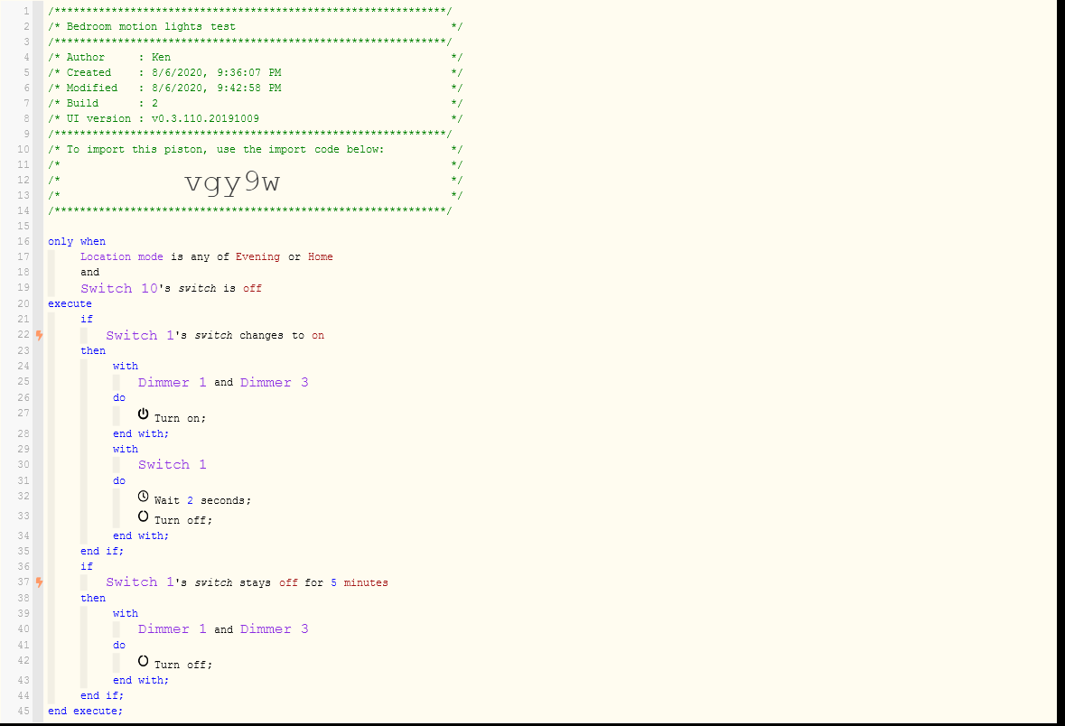

This works pretty well to accomplish what I want:
Now sensor sensitivity of this particular device and latency due to multiple cloud integrations is a whole other story.
Nice… I normally do not recommend using a command which matches a trigger in the same piston… but in this case, it just might work!
