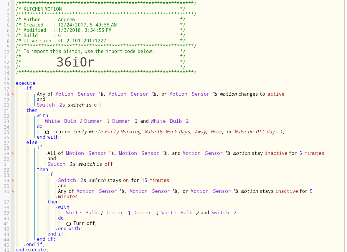

Using motion with virtual switch
( Motion turns on lights, off after 5 minutes unless virtual switch on 15 minutes)
(If Motion is active turn on kitchen lights, if no Motion for 5 minutes turn off, but if virtual switch is on for 15 minutes then check if no Motion in last 5 minutes then turn off Kichen lights and virtual switch. )
(Motion works to turn on and off lights after 5 minutes but when Virtual Switch is on the Piston does not follow up with motion sensors to see if motion has been inactive for 5 minutes so lights do not turn off.)
`( webCoRE
Logs
1/3/2018, 3:44:52 PM +292ms+3ms╔Received event [Home].time = 1515012293002 with a delay of -711ms+176ms║RunTime Analysis CS > 19ms > PS > 100ms > PE > 55ms > CE+180ms║Runtime (40872 bytes) successfully initialized in 100ms (v0.2.100.20171211) (176ms)+182ms║╔Execution stage started+193ms║║Cancelling condition #5’s schedules…+194ms║║Condition #5 evaluated true (3ms)+204ms║║Comparison (enum) on is (string) off = false (1ms)+205ms║║Cancelling condition #13’s schedules…+206ms║║Condition #13 evaluated false (12ms)+207ms║║)`
Looks to me like your if Switch 2 stays on for 15 minutes is being cancelled because in the prior if statement you ar saying if motion sensors stay inactive AND switch is off … then
If it’s off it can’t evaluate as on and this that never fires.
Maybe try simplifying more to what you wrote in your post?
IF
Any of sensors 1, 2, 3, etc. change to active
THEN
—IF
—Switch1 On
—Then turn lights on, wait 5 minutes, turn lights off
—Else turn lights on, wait 15 minutes, turn lights off
