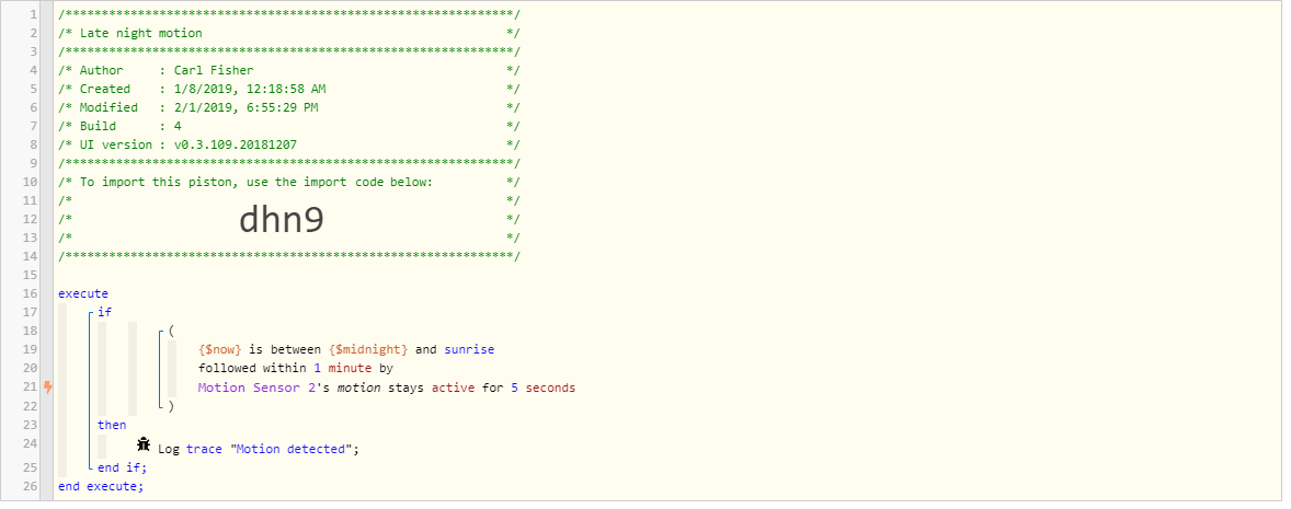

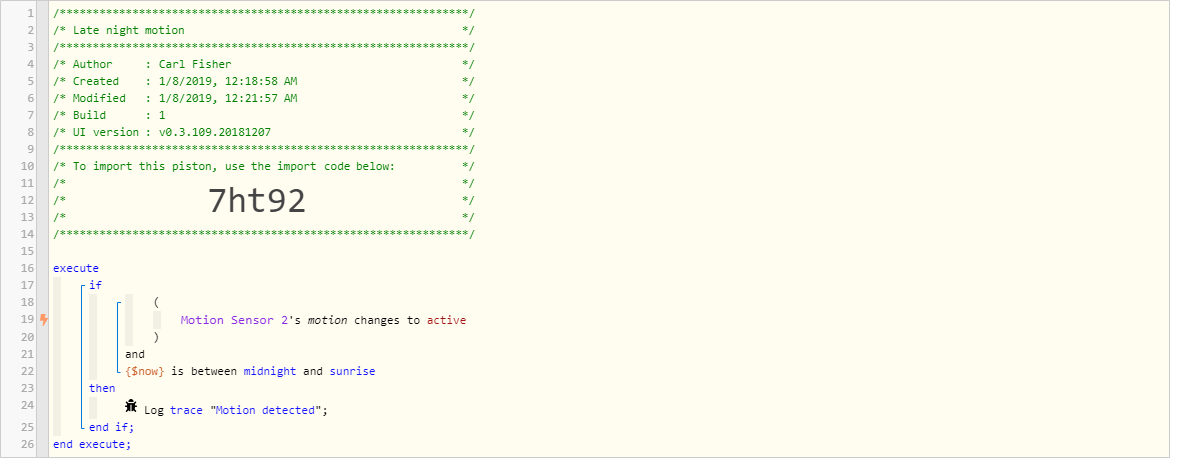

I want to turn our carport light on if my wife or I arrive home after the light’s scheduled off time of midnight. I created a piston to do this using our phones as presence sensors, but they often don’t report presence in a timely fashion.
I recently added a Zooz 4-in-1 sensor in the carport with a thought that we could use it to detect our arrivals. Before I have it control the light, though, I wanted to see how much motion it sees at night normally from birds, bats, bugs, etc. I created the piston below and see there is occasionally activity.
I also see “Piston waited at semaphore messages”, which I understand comes from the motion sensor being triggered repeatedly. I can trace these to times one of us was coming or going- basically, what I’d really like to use as the trigger for the light!
I am new to creating pistons. How could I alter this piston to say, “if motion sensor reports motion for N seconds”…

As he points out, the action doesn’t fire until after the N seconds has elapsed, so it should be less than the time it takes to pull in, stop, and open the car door. The greater N can be, the less likely to be triggered by nocturnal critters other than ourselves. I think I’m settling on about 6 seconds, obviously that can be adjusted if I see a lot more falses as we get into the warmer months.
