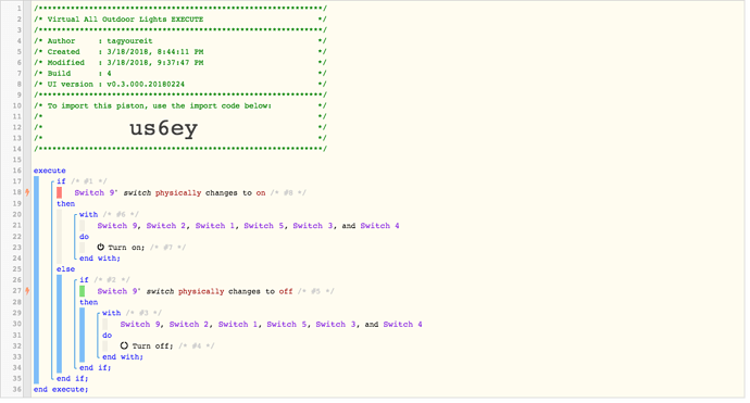

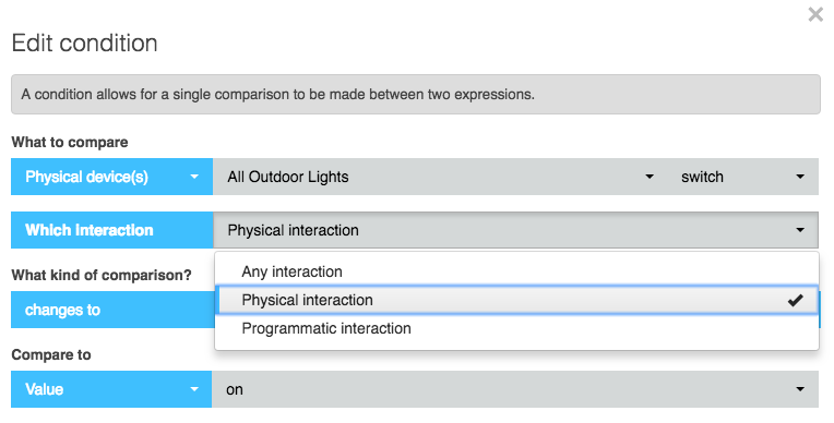

When I went to put these pistons in place, I noticed a new(?) feature of only evaluating an if statement if it is based on a “programatic interaction” vs a “physical interaction”. I thought that this might be a slick way of replacing the “hold” switch in the aforementioned thread, but I’m not successful in getting it to work. I couldn’t find any documentation so I made my best guesses on how it should be functioning.

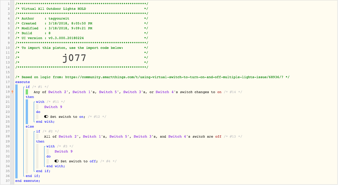

a) Setup a sequence that updates the virtual “Switch 9” if any of the devices I want in my group turn on or all of them turn off. This might be part of the confusion, but instead of using “Turn on” or “Turn off” I thought using the “emulated Set Switch…” to on. So first question is should this later result in a “programatic interaction” vs a physical one? If not, how can I make this a programmatic approach?
b) Setup the piston that will execute if button is pressed directly or this is changed via Alexa (is Alexa turning on a device considered a programmatic interaction? This could be a flaw in my thinking.)
Irregardless of Alexa interactions (I haven’t gotten that far yet), when I turn on any of the individual switches (2, 1, 5, 3 or 4), it turns on the virtual Switch 9 which then turns all of the other switches on.

Are there any loops?
To make a long story short. The pragmatic vs physical will only work if the device handler for the switch gives out the data of a physical interaction or a progmatic one.
There are ways around this however but it would involve using a Boolean variable. You can set it to true when using any programming logic with the switch and then it will be assumed that anytime it is false that there was a physical interaction.
It’s more than just a DTH issue, most devices themselves are not capable of reporting the difference between physical / programmatic, and even the ones that are fail when relaying the data through a repeater in the mesh.
It’s a flawed concept and rarely works.
