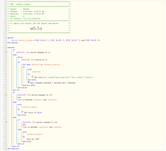

Disclaimer: I’ve been using WebCoRE for a week and am not a developer. I have 4 exterior RGB bulbs and setup a piston so that when a virtual switch is turned on, these bulbs randomly rotate between the colors of my teams (Chiefs, SKC, Jayhawks). Ideally, I’d like to use the specific team colors (found here: https://teamcolorcodes.com/). However, I cannot figure out how to use custom colors in the random expression. Any ideas?
No pride of authorship here, so please let me know if there is a better way to accomplish this.
When virtual switch is toggled, light bulbs randomly change every x - y seconds to one of 2-3 custom colors
I am unable to figure out how to combine the random function with custom colors

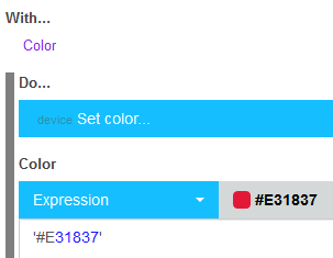

I don’t - I’ll have different pistons for each team. I’m struggling to use a color like “Lead” as it is not a preset color. Do you know of a way to use the Hex Color or RGB values instead?
Yes. That was my next suggestion… To actually test out the conversion to see if you are happy with a specific color. Here is a sample command for testing Chief’s red using “Hex” (my preferred method):
pic
You can save this little snippet, and press Test to see the results.
(Import code: “k44i”)
For reference, you can also try RGB using:
Note: The bulb’s color may not match identically…
Once you are happy with a group of colors, it should be easy to implement random factors.
(especially if you are satisfied with the hex code)
Thanks for the help - i’m going to test out the fix when i get home. I think my ignorance kept me from realizing “red” gets double quotes and ‘#E31837’ gets single quotes. I was trying to do the hex code with double quotes.
Honestly, either single or double quotes will work if you are in the Expression box…
