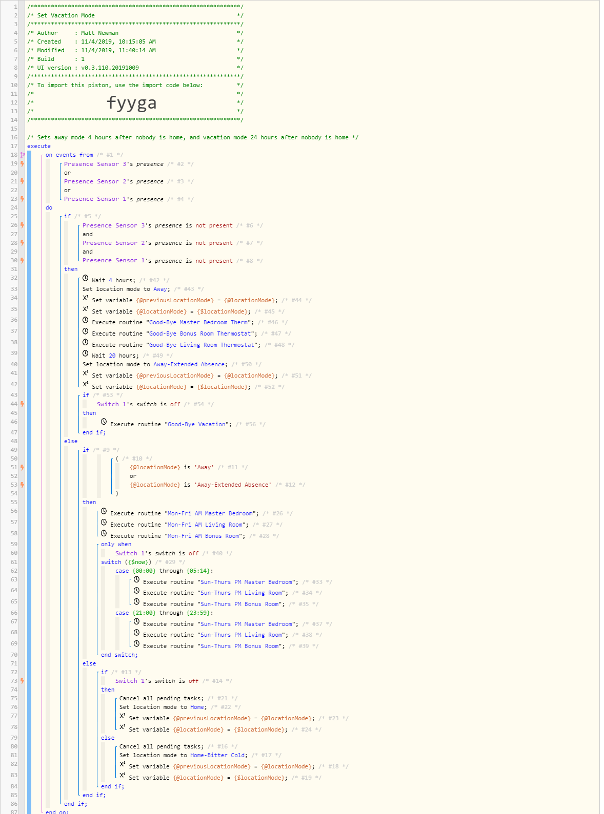

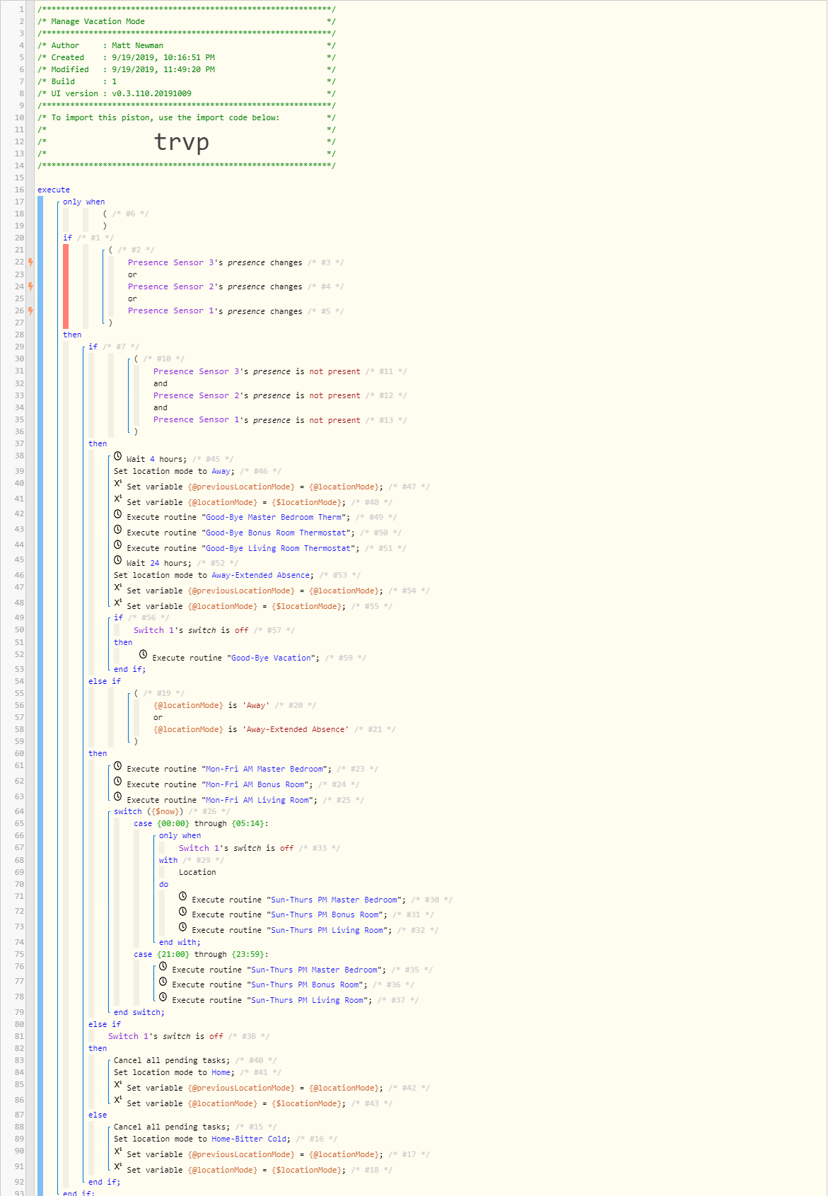

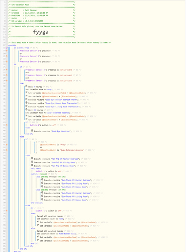

Vacation Mode Piston Help
The Manage Vacation Mode piston is not waiting 4 hours when all presence detectors (iPhones) are listed as Not Present. The piston appears to execute when a presence detector state changes, but does not appear to correctly evaluate that all presence detectors are not present and thus begin the transition to vacation mode. That transition begins with a 4 hour wait to ensure presence detectors are not just running local errands, and then lowers/raises heating/cooling setpoints on the thermostats. From the logs, it appears the piston never correctly assesses all presence detectors not present, even when that condition is true (all presence detectors are not present).
I expect the log to reflect some type of indication that the piston is waiting, possibly a scheduling message as to when the piston will be woken up, but certainly not messages that declare all conditions are false and the piston executed successfully.
Location mode never changes to Away after the required wait time, and thermostat setpoints don’t change to minimize energy usage.

In all above logs, Matt’s iPhone and Barbara’s iPhone were always AWAY. Andrew’s leaving should have triggered the WAIT for managing vacation mode.
If you turn on Trace, then the following will make more sense:
Sorry about that…
Maybe delete the empty ONLY WHEN on lines 17-19… (condition group #6)
I can’t figure out how to do that. I go to edit mode, but I can’t seem to edit what’s already there. I can’t even seem to add new code anywhere. Do I have to type the whole thing in again?
Movement%20handle
Click on the handle of your IF and drag everything outside of your “only when”. Then you can click on the “only when” and delete it.
Thank you. It was a little difficult trying to keep track of which blocks of code were moving where. I finally decided to just re-enter everything from scratch. I used the On Event to trigger the piston to run and then check for the condition where all three presence sensors are not present. So far, everything seems to be working. Here’s the new code:
