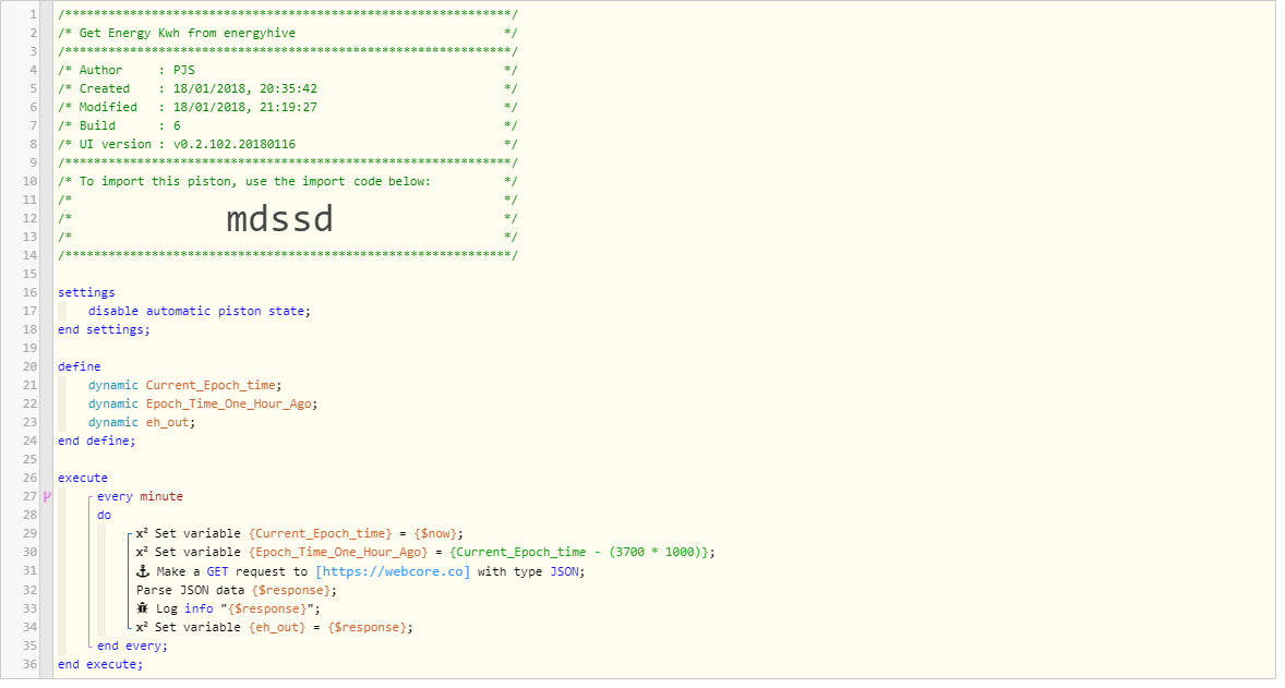

Variable gets included in Web request URL with exponent, not actual number, breaking get request
I have a web request URL built as a value using an embedded expression using {}.
The value stored in the variable is quite large (it’s epoch time), and when the URL is built using the variable the URL is built with the epoch number in the format “1.516305544632E12” rather than “1516306088582”.
This breaks the get request as the webserver is expecting the full number not a number with a decimal point and E12.
Here is the full entry from the ‘Value’ field in the get request: https://www.energyhive.com/mobile_proxy/getTimeSeries?&fromTime={Epoch_Time_One_Hour_Ago}&toTime={Current_Epoch_time}&aggPeriod=hour&aggFunc=sum&offset=0&token=XXXXXXX
I have deleted my api key in the logs and above and replaced with XXXXXX.
If there is another way I can construct the URL that would be fine.
Inserting the variable in the expression using {} should insert the whole number not the exponent (I think that’s the right term!)
The logic is inserting 1.XXE12 not the number
(UPLOAD YOUR IMAGE HERE)

My suggestion is to change your variable type to long instead of dynamic.
Excellent, that worked!
Thanks very much - I am just starting out with webcore and have lots to learn.
