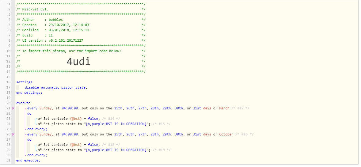

Hi All,
I’m trying to set up a BST/GMT variable to be true or false.
While I can do it using Date and Time and putting in each year, I want to do it so that there is only one entry, not multiple ones.
I have come up with the following idea.
Which I believe will work.
What I want to do is make it slicker by using an expression.
I have the following but want to range the dates. i.e. 25 to 31.
Can you help with that part please. This is what I have without the dates.
Thanks in advance.
EDIT: I’m happy with setting the variable, just the ranging of the BST period.

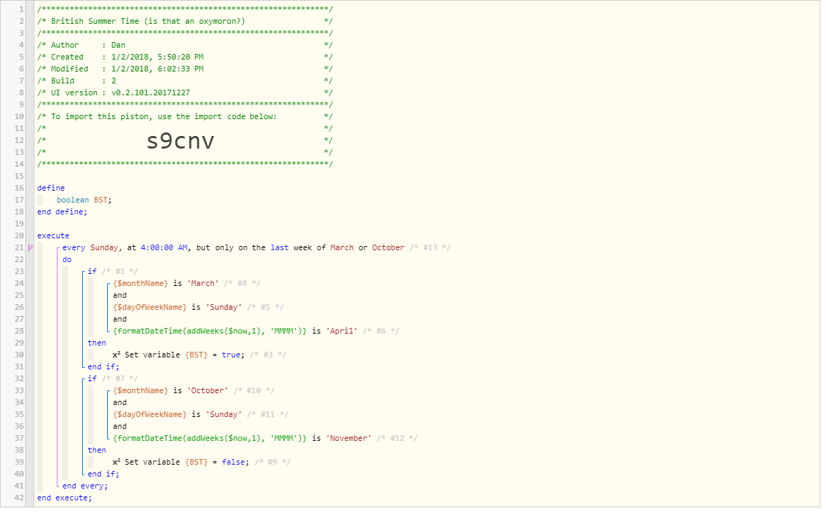

I verified the logic works in the IF conditions here (evaluates true on the last Sunday or March or October) but the timer functionality could be used to generate the same result. I couldn’t think of a way to verify the timer, though.
Do you have a preference when it comes to timer vs. IF conditions?
If I misunderstood what you’re after - what range are you looking to extend the dates to?

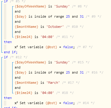

Something like this?
This is what I have come up with.
Very similar to what you have just said.
EDIT: Ignore the deliberate mistake. :wink:
