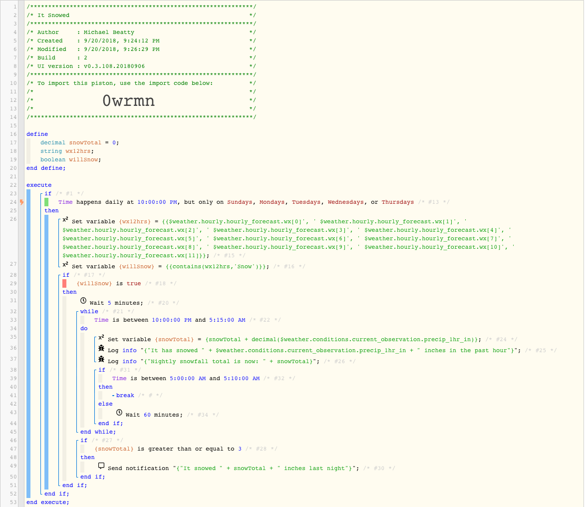

I’m using the Weather API to get the hourly snowfall total and incrimenting a snow total variable, when 1 inch falls in one hour, its supposted to add that to the pervious snow total
The variable is not incrimenting, its just overwriting with the current hour’s snow total.

Nothing stands out when I looked at it. Only thing I’d suggest is to add a Log to console snowTotal and the decimal($weather.conditions....) before Line 35 just to see the data.

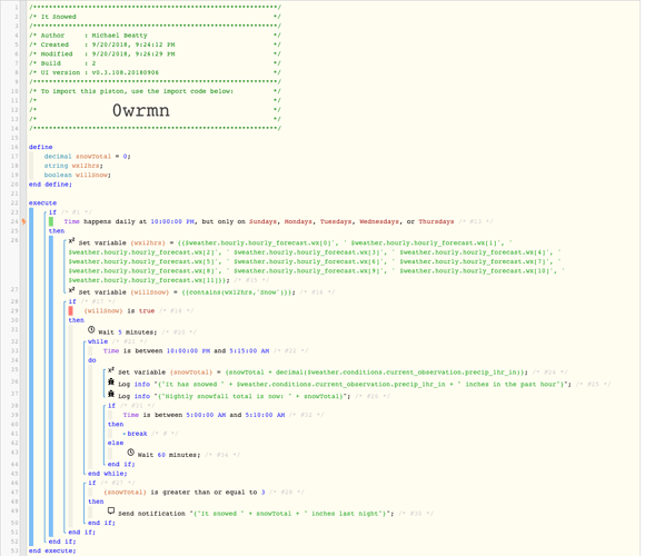

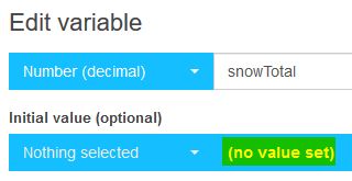

This is because you hard coded a zero on line 17, which basically resets the variable each time it runs. You can change that line to this:
temp
(Just be aware that it will keep adding indefinitely unless you reset the number occasionally)
I was thinking it would stay in the while loop until next day?
I see what you mean. but from the log, it looks like it starts at the top (and resets to zero) each cycle.
