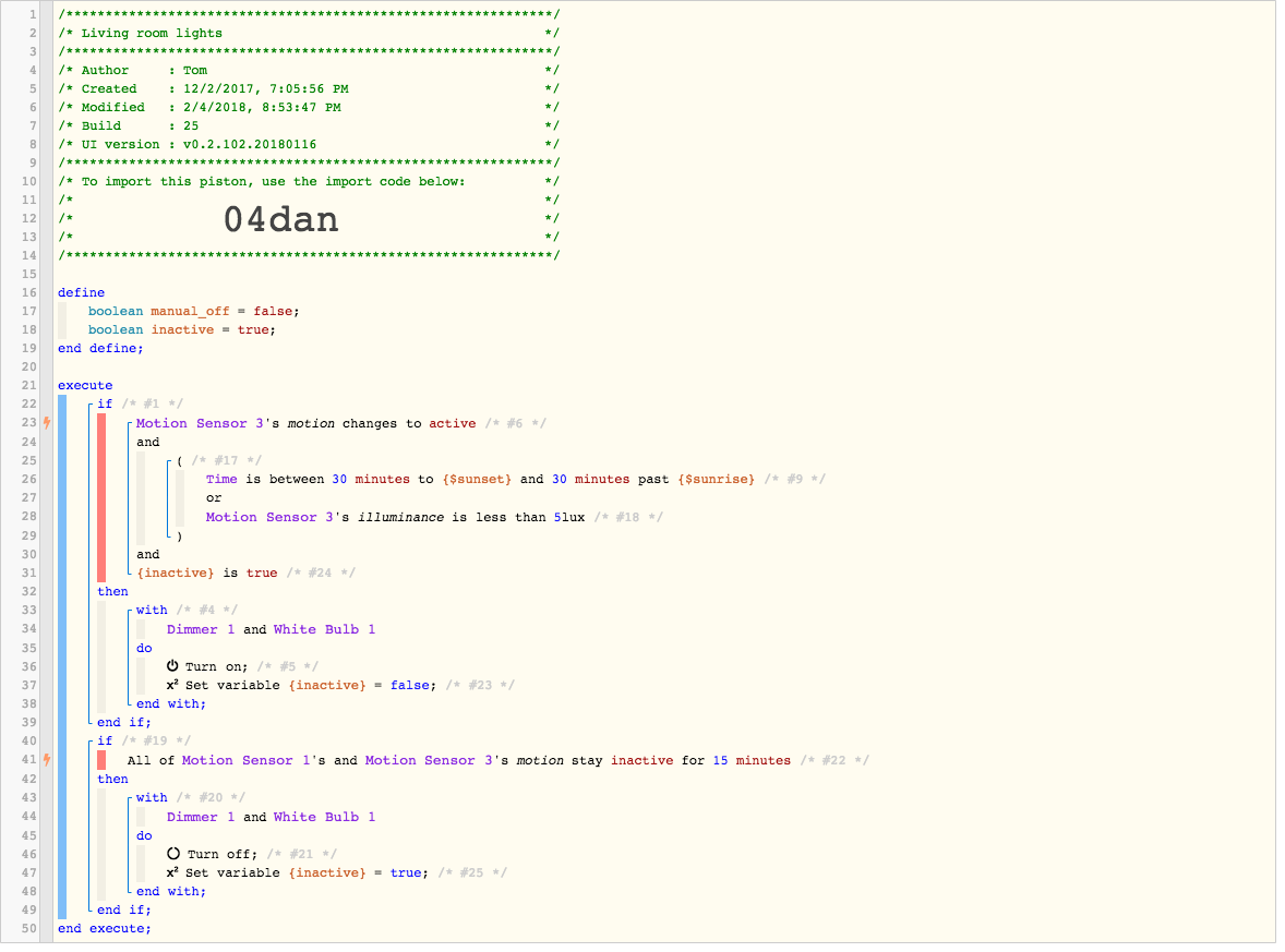

My variable inactive will not set to false. Why will it not change. The light comes on as expected.
The light comes on and inactive is set to false.
the inactive variable is stuck true even though it is a dynamic variable.
The problem is you are assigning the variables within the definitions, which means the definitions will reset back to the defined value every time the piston runs. So they start as defined, update when the trigger to turn the lights on is satisfied…then when your off trigger sets, the variables reset again.
What you need to do instead is defined them with no value. Then have them updated in the two triggers.
Now, the unintended consequence, and there always is one, is your pistons may not run with the variables initially undefined. So I usually include a switch operation in there to set the initial variables by manually turning the lights on or off. You could also do this within the ST app.
