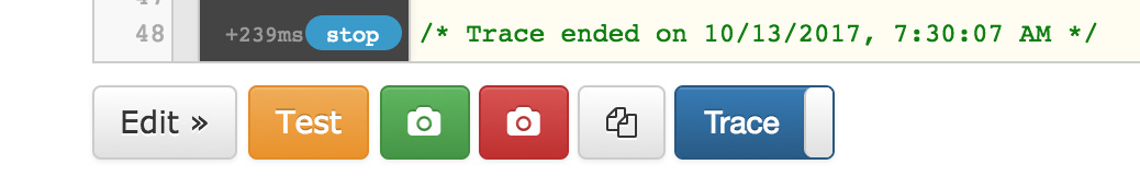

Now I’m seeing the extra variables from the original piston I copied, but didn’t use. Any idea how to make that go away? I can’t seem to directly edit the piston. I’m probably missing something though.

once you are viewing the piston, edit button is at the bottom left of the piston:
