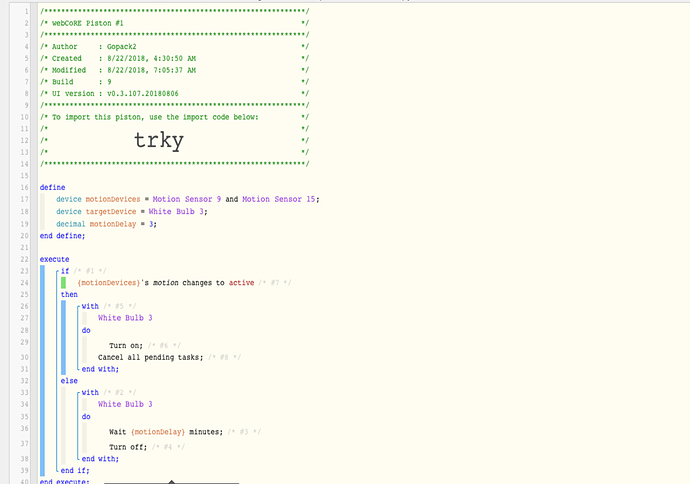

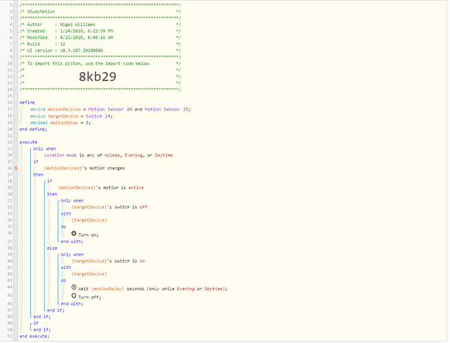

I am encapsulating a set of motion detectors into a single virtual switch.
Virtual switch is on when any motion is detected.
Virtual switch to switch off when there is no motion and the wait has completed. If there is a subsequent motion action during the wait then the virtual switch remains on until all finished.
If this piston is sitting on the Wait (no motion detected) and there is a subsequent motion action during this period the virtual switch turns off regardless.
