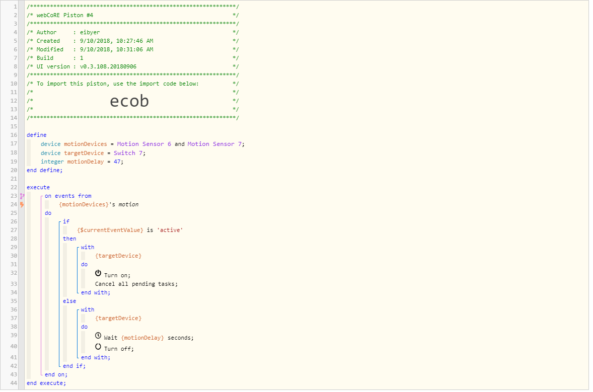

I have a virtual switch to encapsulate multiple motion detectors.
When any of the motion sensors activate then switch on the virtual switch.
When all the motion sensors become inactive then turn off the virtual switch.
See above
Ocassionally it seems that the piston is missing the event when all motion sensors become inactive.

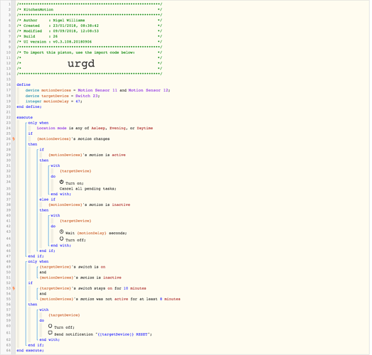

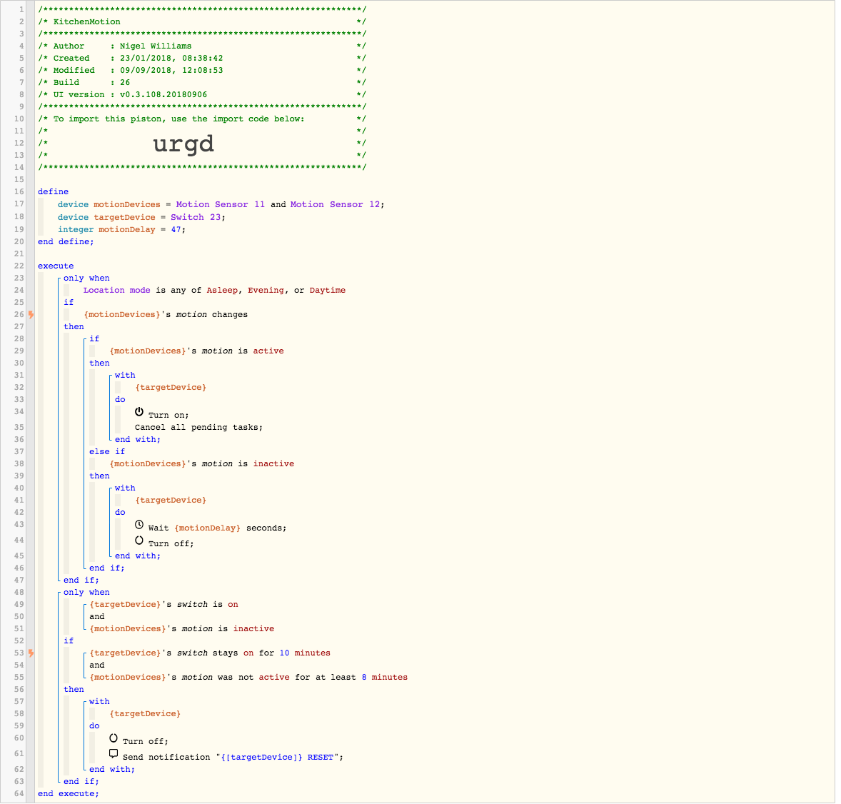

I have added a guard to reset the virtual switch when the virtual switch stays on even though the motion sensors are inactive. but would like to resolve this.
Your advice is appreciated
