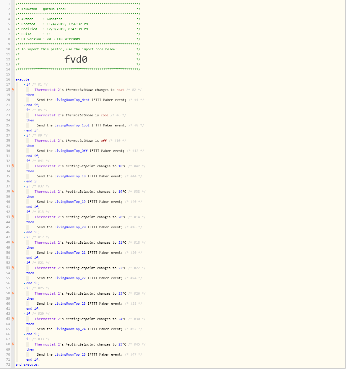

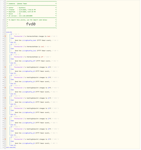

Hello guys,
Im trying to create a piston for controlling Air Conditioning with BroadLink RM Mini 3 and RM Pro. For Some reason everything was fine and suddenly stopped working from what Im seeing in the Full log is not creating the Virtual command to IFTTT I also tried with GET parameters. Here is some info.
Here is some screenshots and logs.

Two observations about your logs:
8:45:01 PM
╔Received event [Климатик Таван].heatingSetpoint = 23
║╔Execution stage started
║║Condition #26 evaluated false
║║Condition group #25 evaluated false (state did not change)
In this first log, the heating point went from 23 to 23, so there was no change, so no IFTTT command was sent…
8:45:21 PM
╔Received event [Климатик Таван].thermostatMode = off
║║Condition #10 evaluated true (6ms)
║║Condition group #9 evaluated true (state changed) (10ms)
║║Executed virtual command iftttMaker
In this second log, it looks like the IFTTT command was sent…
Yes on the states is working but the temperature is not working. And I`m 100% sure that the heatingSetpoint was on different degree I did the check with all of them from 18 to 25.

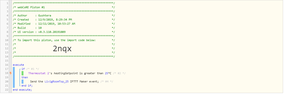

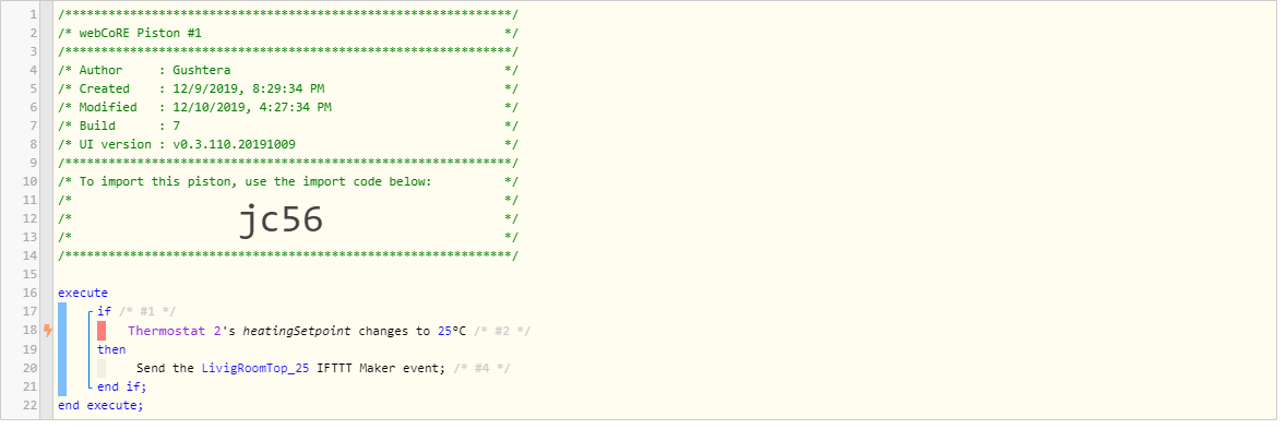

Here I created a simple piston with only one if. And look the log.
12/11/2019, 10:44:44 AM +799ms
+1ms ╔Received event [Климатик Таван].heatingSetpoint = 25 with a delay of 48ms
+64ms ║RunTime Analysis CS > 17ms > PS > 36ms > PE > 11ms > CE
+67ms ║Runtime (36995 bytes) successfully initialized in 36ms (v0.3.110.20191009) (65ms)
+68ms ║╔Execution stage started
+76ms ║║Comparison (decimal) 25.0 changes_to (integer) 25 = false (0ms)
+78ms ║║Condition #2 evaluated false (5ms)
+79ms ║║Condition group #1 evaluated false (state did not change) (6ms)
+82ms ║╚Execution stage complete. (13ms)
+83ms ╚Event processed successfully (83ms)
12/11/2019, 10:44:30 AM +290ms
+2ms ╔Received event [Климатик Таван].heatingSetpoint = 23 with a delay of 53ms
+69ms ║RunTime Analysis CS > 17ms > PS > 37ms > PE > 15ms > CE
+72ms ║Runtime (36995 bytes) successfully initialized in 37ms (v0.3.110.20191009) (69ms)
+81ms ║║Comparison (decimal) 23.0 changes_to (integer) 25 = false (0ms)
+83ms ║║Condition #2 evaluated false (5ms)
+84ms ║║Condition group #1 evaluated false (state did not change) (6ms)
+86ms ║╚Execution stage complete. (14ms)
+88ms ╚Event processed successfully (88ms)
Look what I did and is working like that just for the test, but I can`t use it in real.
+1ms ╔Received event [Климатик Таван].heatingSetpoint = 26 with a delay of 45ms
+58ms ║RunTime Analysis CS > 15ms > PS > 31ms > PE > 12ms > CE
+61ms ║Runtime (37094 bytes) successfully initialized in 31ms (v0.3.110.20191009) (58ms)
+62ms ║╔Execution stage started
+71ms ║║Comparison (decimal) 26.0 is_greater_than (integer) 25 = true (2ms)
+73ms ║║Cancelling condition #2’s schedules…
+74ms ║║Condition #2 evaluated true (7ms)
+75ms ║║Cancelling condition #1’s schedules…
+76ms ║║Condition group #1 evaluated true (state changed) (10ms)
+78ms ║║Cancelling statement #3’s schedules…
+381ms ║║Executed virtual command iftttMaker (299ms)
+384ms ║╚Execution stage complete. (321ms)
+385ms ╚Event processed successfully (385ms)
