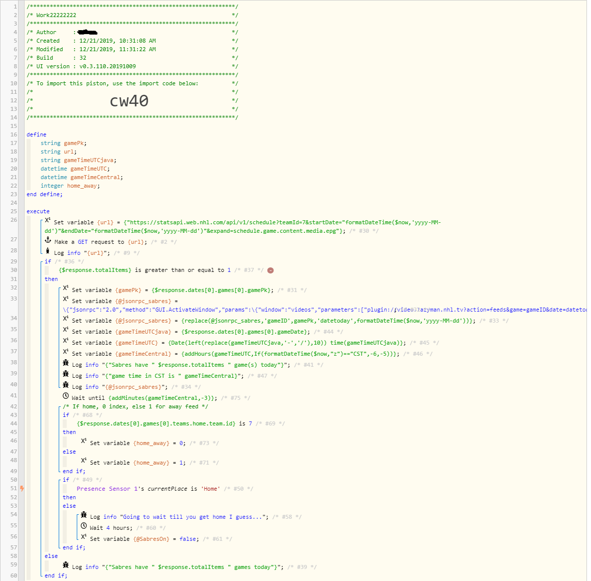

The following piston does not run when I have the “wait until” nested inside (line 41). I have turned on FULL logging. Nothing happens. There is just nothing in the log, its like the piston doesn’t fire at all. When I delete the ‘wait until’ statement the piston functions as expected. I tried putting it elsewhere in the piston, and it still breaks. I also tried setting it to wait until a specific time, or wait for x seconds to troubleshoot but to no avail. I can’t even insert a “wait” statement in the top block where it sets the ‘url’ variable. For some reason, the Wait 4 hours in line 55 does not seem to affect the piston.

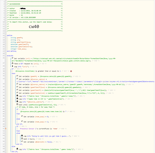

Piston runs, waits until the expected time, then continues.
With the wait statement in… nothing. I turned on full logging and nothing shows up. When I delete the wait statement the piston functions as intended.
No logs, piston does not execute. For reference. I have included the logs
generated without the “wait” statement.
