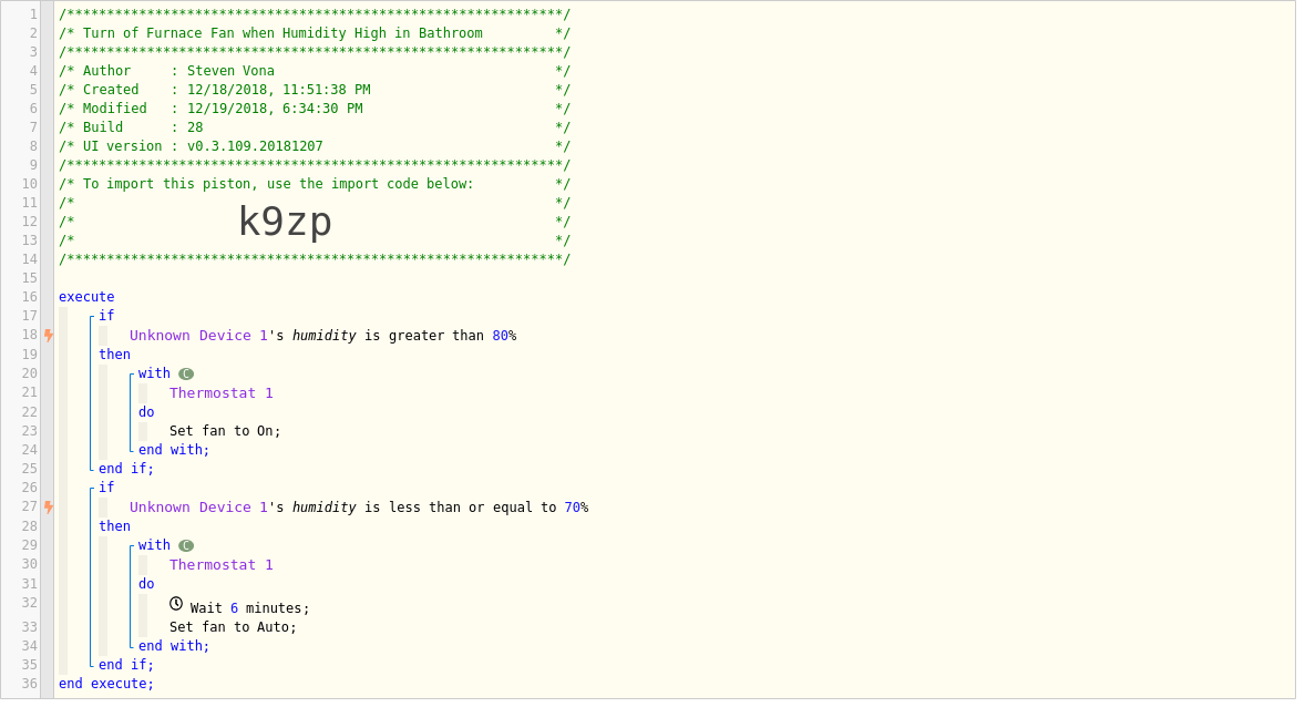

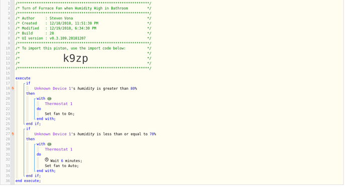

Wait function not working on Piston
I am trying to make my furnace fan turn “on” when humidity is over 80% in my bathroom, then wait for 10 minutes and turn the fan back to “auto mode”. The piston fires off fine when 80% threshold is hit, but it seems the wait is never executed.
Fan turns on when humidity hits 80%, waits 10 minutes, then puts the fan back to “Auto” mode for normal furnace functionality.

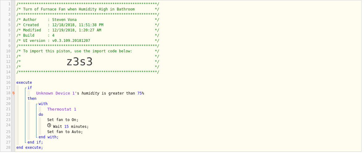

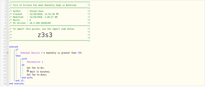

Ok, So I think I fixed my own issue.
I set the Task Cancellation Policy to “never cancel task” and I am doing some testing. So far it looks like the right answer. I never knew the TCP existed (noob).
great stuff!
Ok, So i am still not getting the results I expect.
Where should the Task Cancellation Policy be applied? or the condition or the task?
Hi @savona
Click on WITH
and add it there…
I have not tried using NEVER CANCEL with a condition so, IF you still don’t get the result you want, try using a trigger
IF humidity raises above 75 (trigger)
I finally got it working with an hour or so playing around. I applied the TCP to the tasks.
I am glad it worked…great…
