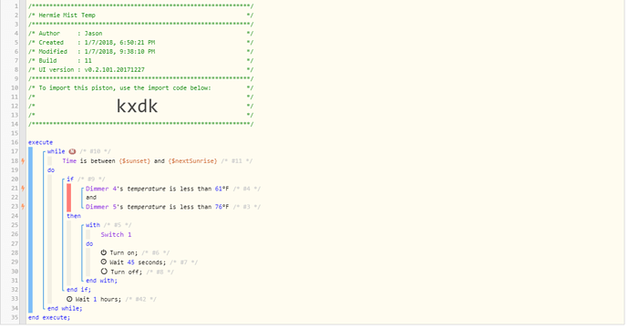

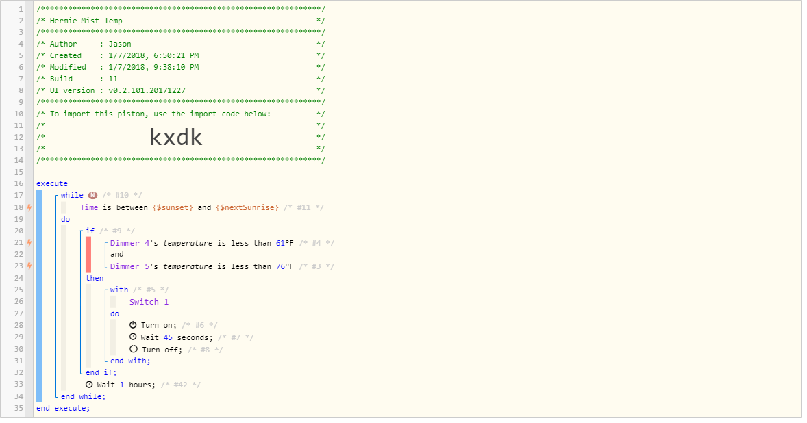

The 1 hour Wait resets on change of temp inside while
I need the wait to not reset when a temp change
I have tried with TCP on and off
What am I missing here?

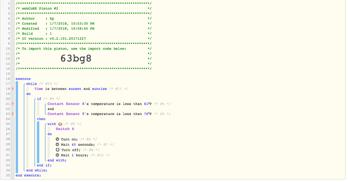

That is how i tried it before but with no luck. Need someone advanced to tell me if this is a bug or expected behavior.
When a variable in the if changes as in temperature it goes through the if all over again and the hour timer gets reset.

for both the if conditions change subscription method to never.
if that alone does not work also set TCP to never.
That worked. Thanks! I still don’t know all the settings within webcore yet. I knew it was probably going to come down to just a setting. I was unaware you could control the subscription method.
As we say in code now it will no longer fall through. Hopefully I can help someone else if they run into a similar issue.
