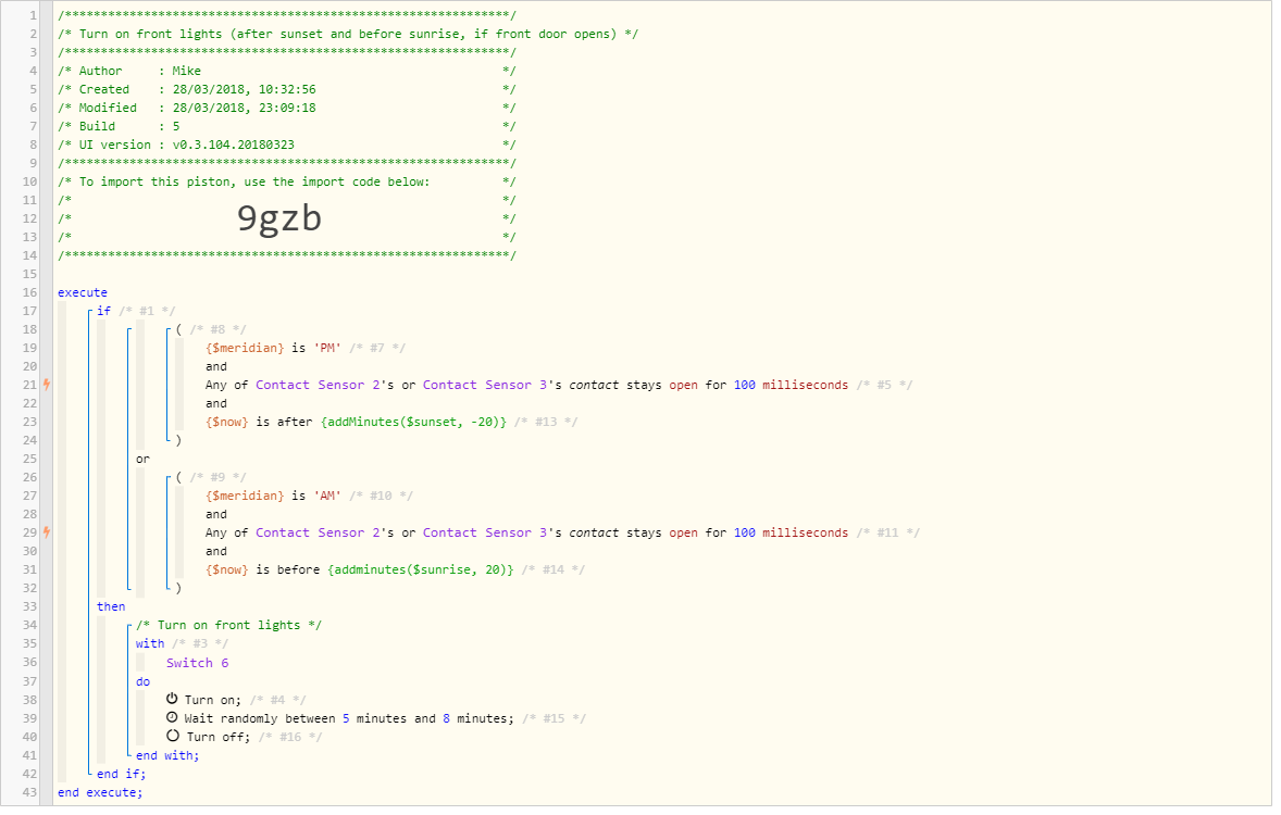

Wait random time not working (or prob user error)
Light is not turning off randomly between 5 and 8 minutes
Lights turn off after waiting between 5 and 8 minutes
Lights turn on as expected, but not turn off. Nothing happens, after “Turn ON”

Nothing happens at the wakeup time. Light is still on. And it’s 20 mins later. Here are the logs for the wakeup

I would suggest creating a toned down version of that piston. Start with Contact Sensor changes to open, turn on, wait randomly between X and XX seconds, turn off. Just to test.
So I tried your suggestion, and the piston works as you would expect if the door remains open, but if the door shuts, then the piston is cancelled.
I’ve tried “changes to open” and a few others, but each time the door shuts, the piston is cancelled and doesnt run the turn off command.
Thoughts?__
In the With, click the cog icon and set the task cancellation policy to never.
Thanks, that did it. I was on the right track, but I was doing it with the first IF statement, not the WITH statement.
