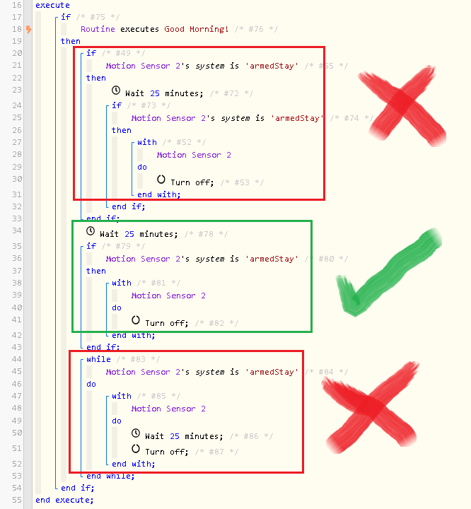

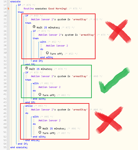

I can’t figure out how to encapsulate a Wait Task, then an IF condition, within a single statement. I can only get it to work if the Wait is a task then the IF is an entirely separate statement. This works, but it doesn’t seem correct. Looking at the below image, the red options do not work, only the green one does (“Motion Sensor” is actually my ADT alarm panel, hooked into SmartThings using AD2SmartThings).
Wait for 25 minutes, then turn off the device if it is not already off.
Device does not turn off.

It will still work if the Wait is not within the If statement, the piston will get evaluated from top to bottom.
I know. But it makes it harder to manage the position when the wait is outside the IF.

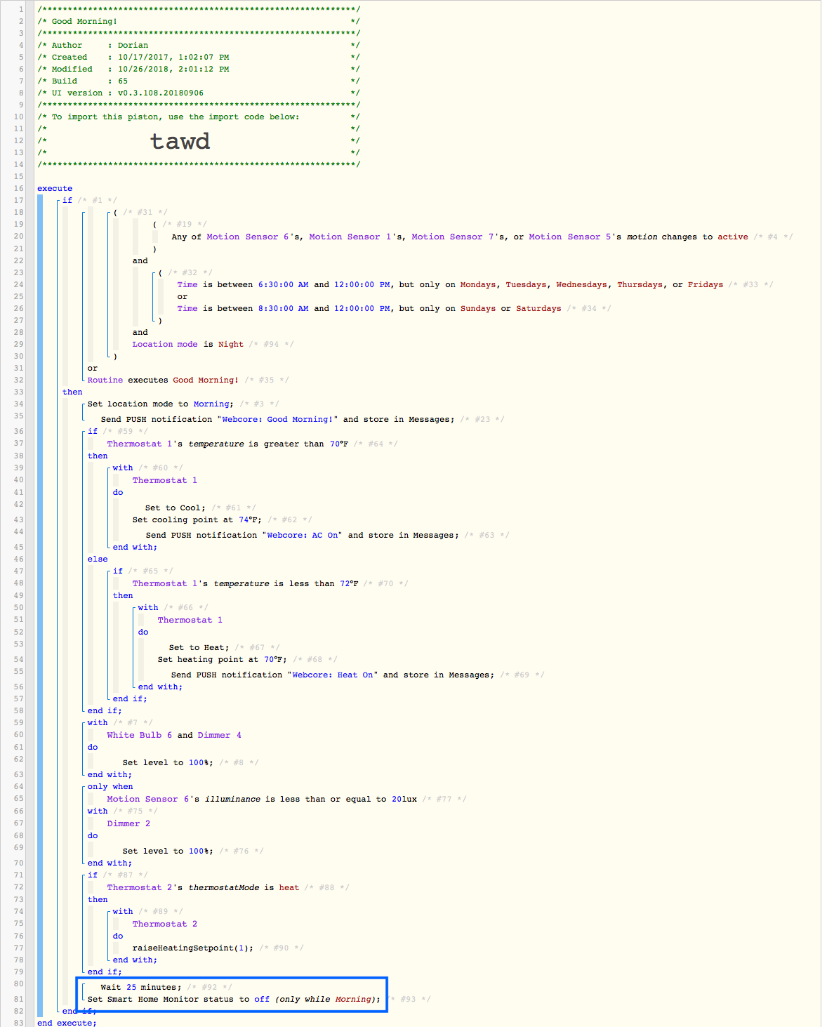

Doing the below achieved the desired result. Importantly, the restriction prevents the alarm from being turned off if I’ve already left the house - in that case the mode would not be Morning.
