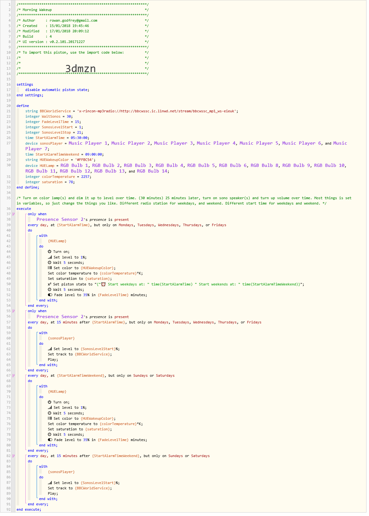

Would someone review this Piston for me? It’s based on another Wake Up Piston I found, but simplified. What I want to happen is as follows;
15 Minutes before Wakeup Time, Lights on, fade from 1% to 35% over 15 Minutes.
After 15 Minutes start Sonos (BBC World Service)
Same Piston for weekdays and weekends, different start time.
I want lights to stay on, Sonos to keep playing. I will use a generic leaving the house piston to switch everything off giving me greater flexibility.
