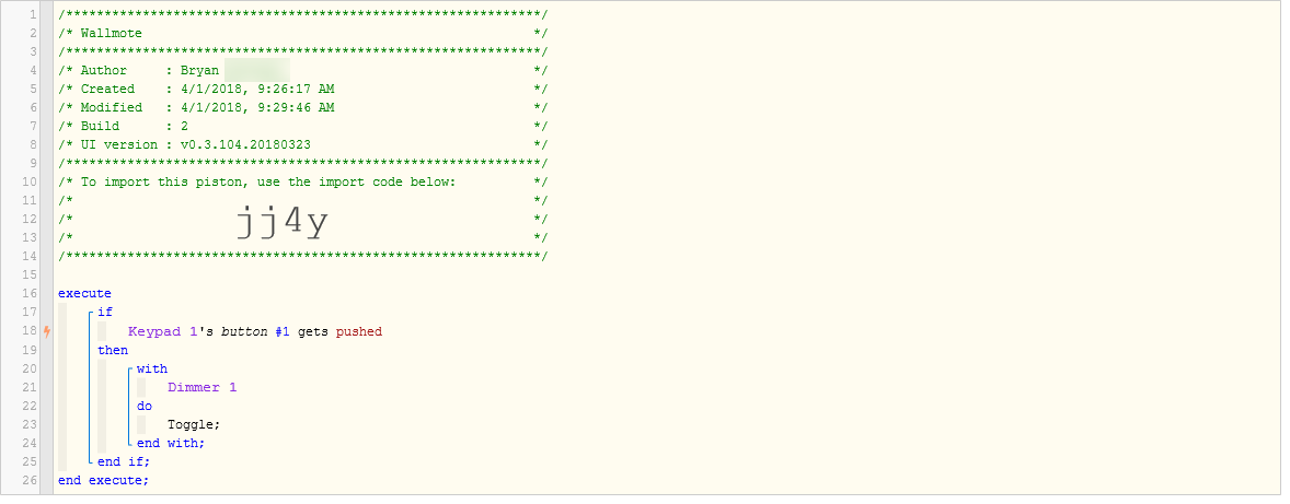

I’m not sure if this a webCore issue, a DTH issue or a ST issue, but I’m hoping that those of you that are more proficient than I in reading logs may be able to identify my problem.
I am using an Aon WallMote to turn smart bulbs on and off (i.e. toggled). The piston generally works as intended to toggle the targeted bulb, but there are times when a press (held in WallMote speak) does not work. I’m posting four log entries made starting with the light on.
I did four touches, each of which are reflected in the logs. The first touch properly resulted in the light turning off. The remaining three touches which should have turned the light on or off did nothing.
Maybe the issue is with the “toggle”. I’ve thought of using IF it’s on turn it off and vice versa, but haven’t tried that yet.
Here is the DTH I’m using: https://community.smartthings.com/t/release-aeon-wallmote-dual-quad-2-4-button/74834
Keypad1 is the WallMote; Dimmer 1 is a Cree connected bulb
I expect each touch to toggle the bulb, turning it on if it’s off or off if it’s on.
There are times this works as intended, and other times touching the WallMote does nothing.

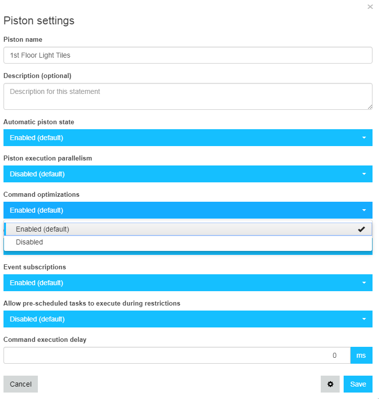

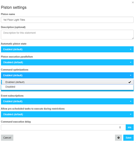

You can change it by disabling “Command Optimization” in your piston settings.
While in Edit mode, click on Settings at the top of your piston. Then click the gear cog to expand options (I think only Piston State shows when you initially click settings).
If you can’t see settings at the top of your piston, click Options in the upper right corner and then choose Show Piston Settings.
Thanks! I was thinking that’s was that option did but wasn’t sure. That solved the problem with the command being sent, but the bulb is still erratic. I’m going to chalk this one up to the fact it’s a GE Link and swap it out. The other bulb, a Cree Connected, works perfectly.
