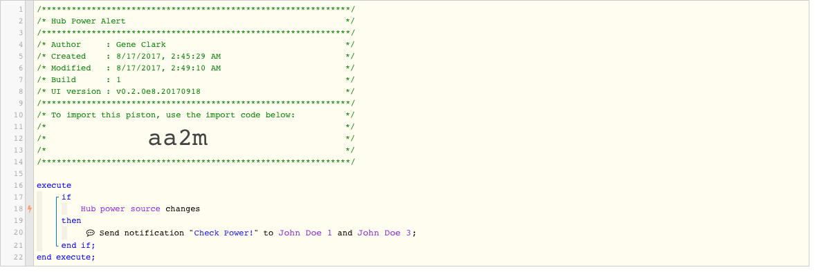

I’m not sure if it’s even working or not because I seem to get notifications even when the power “seems” to be fine.
Push and text notifications every time the hub loses power

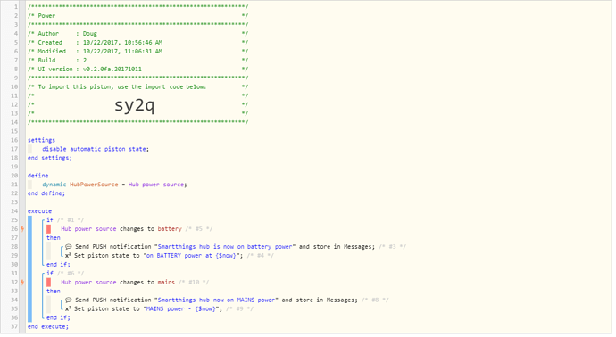

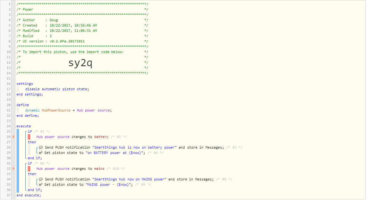

Changed it to this… Don’t mind be other stuff I’ve added in there - playing around trying to learn how to do this better.

I have the same problem. My piston is pretty simple, just subscribing to different power source change types, the power change event is never fired. IDE reflects the power source changes, but webCore never sees it.
No word as to why these events are lost?
I’m not sure because I’ve literally unplugged my hub and never got any notifications, but yet sometimes get notifications when the power seems fine.

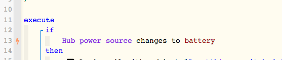

Looks like the original question has not been answered yet? I have the same issue as @omayhemo. Simple piston to send an SMS when Hub ‘changes to’ battery power. I unplug the Hub and confirm in the IDE it shows battery power but Piston does not fire.
Any ideas on why the Piston does not work? I have a second home in the Mountains that loses power fairly often and I need a way for a Piston to run that tells me so.

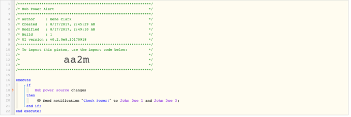

This is what I ended up with for a piston and the only time I get alerts is when they rollout new firmware and reboot my hub. However if I go into IDE and reboot my hub I won’t get an alert. Furthermore I can pull the plug on the back of my hub and still nothing. What’s more frustrating is I tried adding power status to piston state and will only show battery. Am I misunderstanding how this command works in webCoRE? I’ve see the home status and hub power tiles piston elsewhere in the community but I’d just like a simple piston with no tiles.

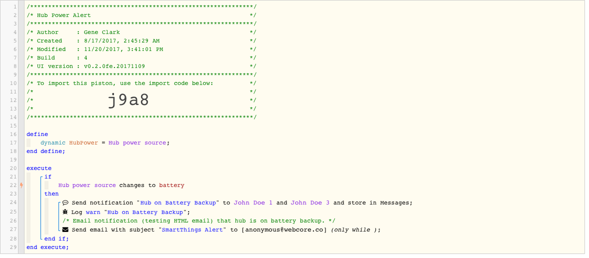

Anyone figure this out yet? I have the same issue…
