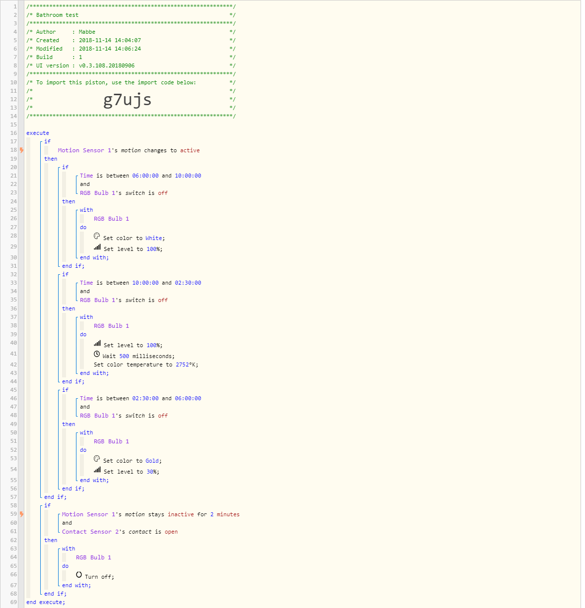

Hi everyone, I just recently got my ST and started automating with webcore.
I’m now moving some automations here and ran into this problem.
This was my solution for having the motion sensor in the bathroom but using a door sensor to not turn off the lights while the door is closed. If the door is left opened and no motion is triggered i want the lights to turn off.
When motion is triggered the light of the bathroom turns on to a specific color based on the time of the day. If i now for example manually set the lights to blue (through google assistant for example) I dont want the color to revert to white again as soon as motion is triggered.
When i manually set the color of bulb i want it to stay like that until it turns off. I still want the “no motion for 2 minutes” AND “if door open” to turn off the bulb
Manually changed color reverts when sensing motion.
I hope i was clear in my description of my issue.
Thanks in advance!

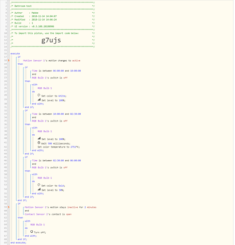

After some thinking and reading i decided to try this, not sure if it will help and im still at work and cant test it right now.
I’ve added “IF bulb is off” under the “if time is between”.
So hopefully the motion sensor only triggers if the bulb is off.

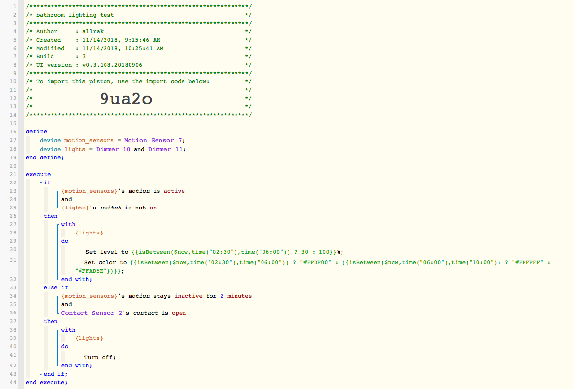

Try this:
I tried to match your color temp of 2752, it’s in the ranges of:
2700: (255, 169, 87),
2800: (255, 173, 94),`
rgb(255, 173, 94) = #FFAD5E
