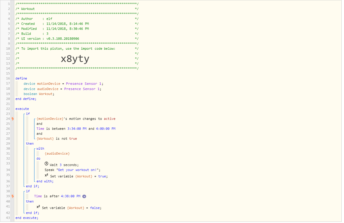

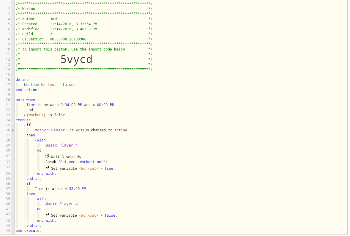

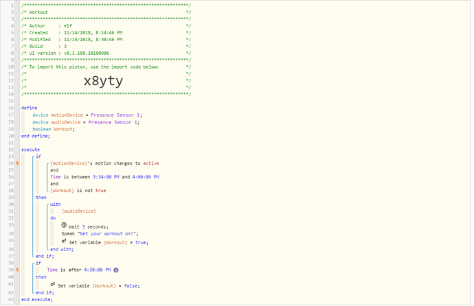

The piston fires multiple times
I’m trying to set a variable so that the piston only fires when the variable is false to keep the piston from firing multiple times and or when I don’t want it to.
I’m either not setting the variable correctly, or I have something else wrong as the piston fires more than once.
