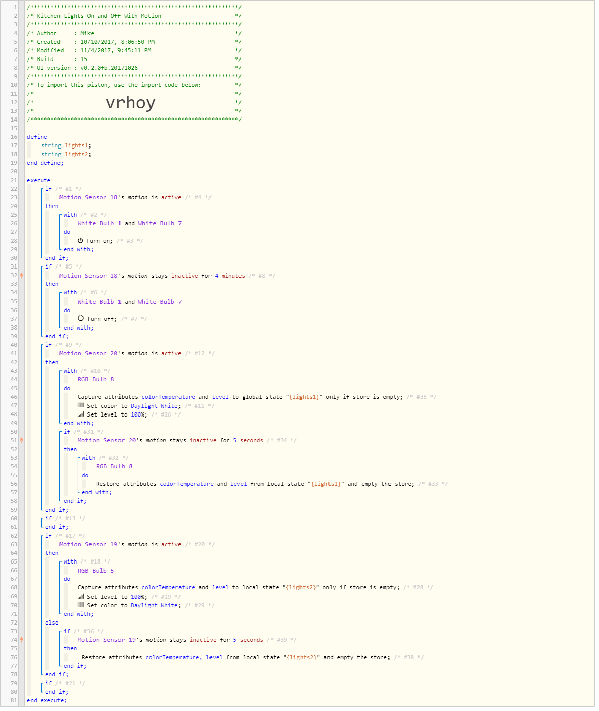

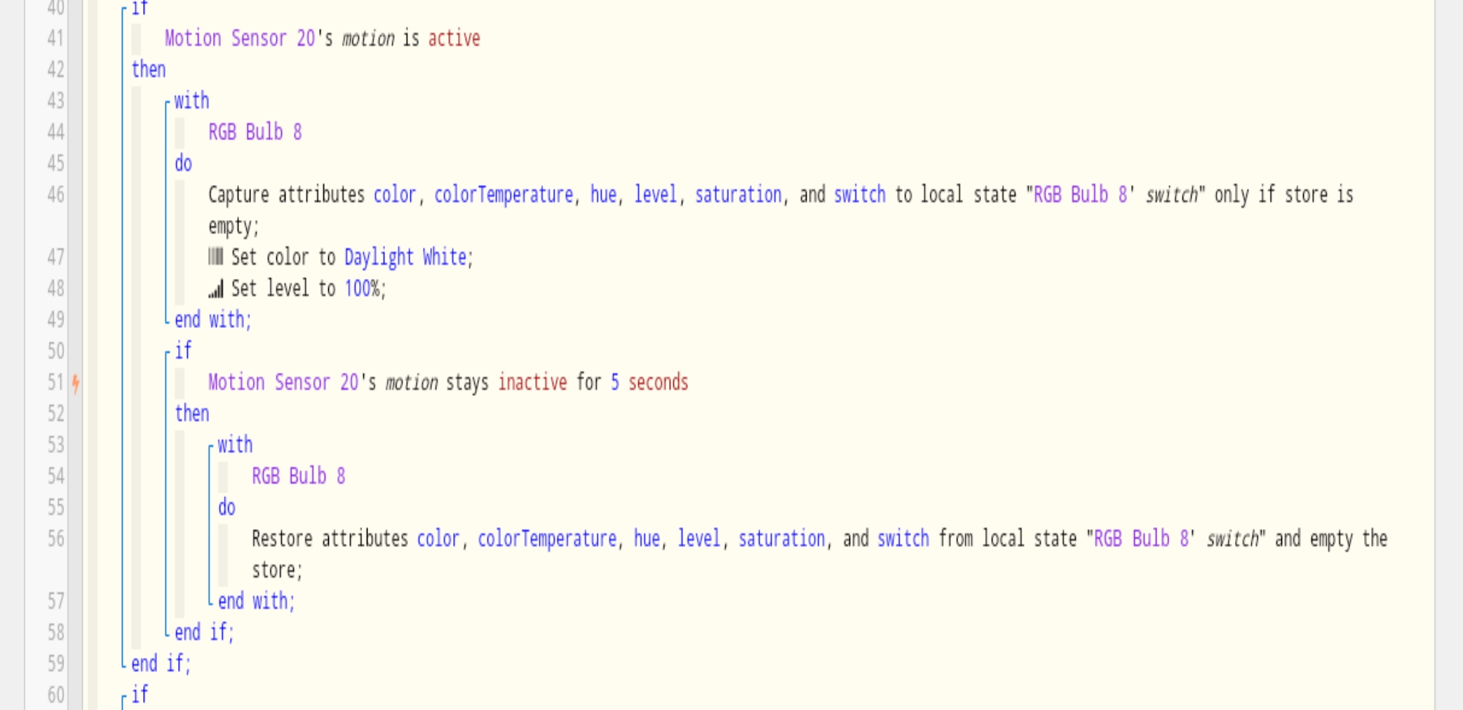

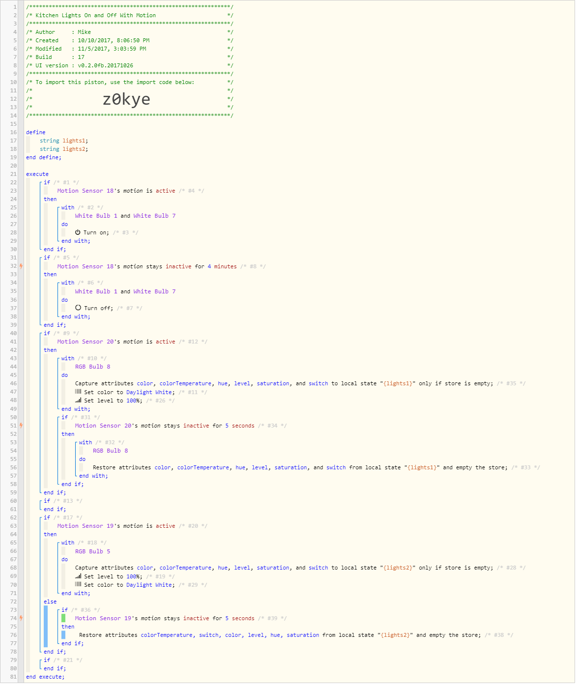

Want RGBW LD strips to return to color they were before motion
I have a piston that runs when a momentary button is pressed that changes my LED strips and a few bulbs a specific color. That runs fine. Then i have a kitchen lighting piston that turns on the kitchen lights (2 fixtures) when Kitchen Motion is active and off when its inactive, then 2 different LED strips that live under the cabinets turn on (sink lights with sink motion, oven lights with oven motion). They go off after inactivity of their respective motion sensors. Heres where i get stuck.
When the team color piston runs, it turns the LED Strips in the kitchen a specific color (red, blue, orange). So i want to walk into the kitchen and have the LED strips turn daylight white no matter the situation. then when the motion sensor is inactive for the configured, return to the previous state - whether the light strip was off, or a specific color. The team color piston turns the strips the right color, but the kitchen light piston doesnt return the original state.
The kitchen lights turn daylight white when i walk in, like they are supposed to. But no matter what, they return to daylight white. They should go off, or change back to whatever color they were before walking in.

hopefully this is the info needed. thanks!
instead of using global store capture and restore attributes from individual named stores for each light. also the switch is not captured or restored. to return light to previous light power state that would be required.
I think im storing the attributes to a local variable but its still doing the same thing. the lights go back to daylight white, not the color or level they were before. is it storing 100% and daylight white? if so, how do i get it to store the state/attributes before the motion starts/lights change?
The local store is different from the variables… when saving / restoring to local store you should be choosing the device not a variable.
Ok. Something more like this? I’m not home so I can’t test it yet
That’s only saving the state for f the switch (on/off)… you need to save colour as well.
