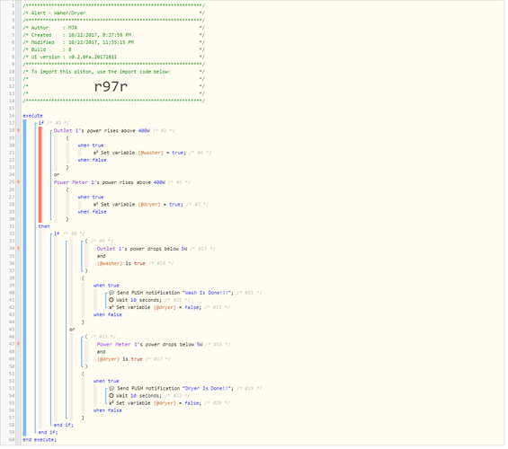

I am not getting alerts.
Send me an alert
It looks like the THEN portion is not working

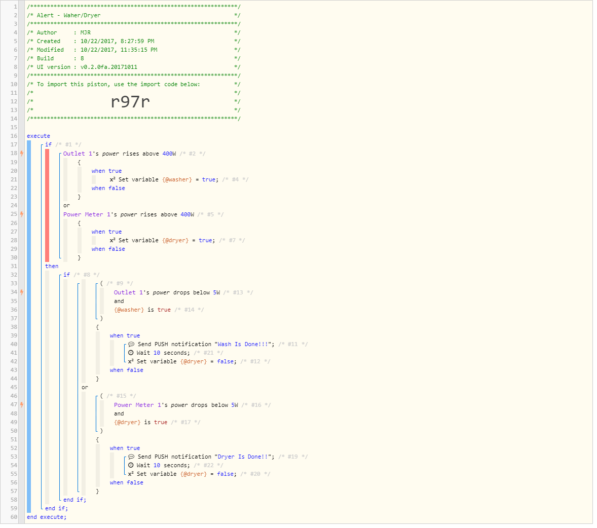

Thanks for fixing the image
I did take it after it should have run. I will re run now and get logs
If you are unfamiliar with the trace lines then let me explain them. You see several gray lines next to each condition/action/group etc
Blue means something was evaluated/executed.
Red means conditions were not true
Green means conditions were true
Notice your blue line. Your piston in it’s entirety was evaluated. Next in we see the red line. Meaning neither of your conditions were true. So that was the end of the evaluation.
