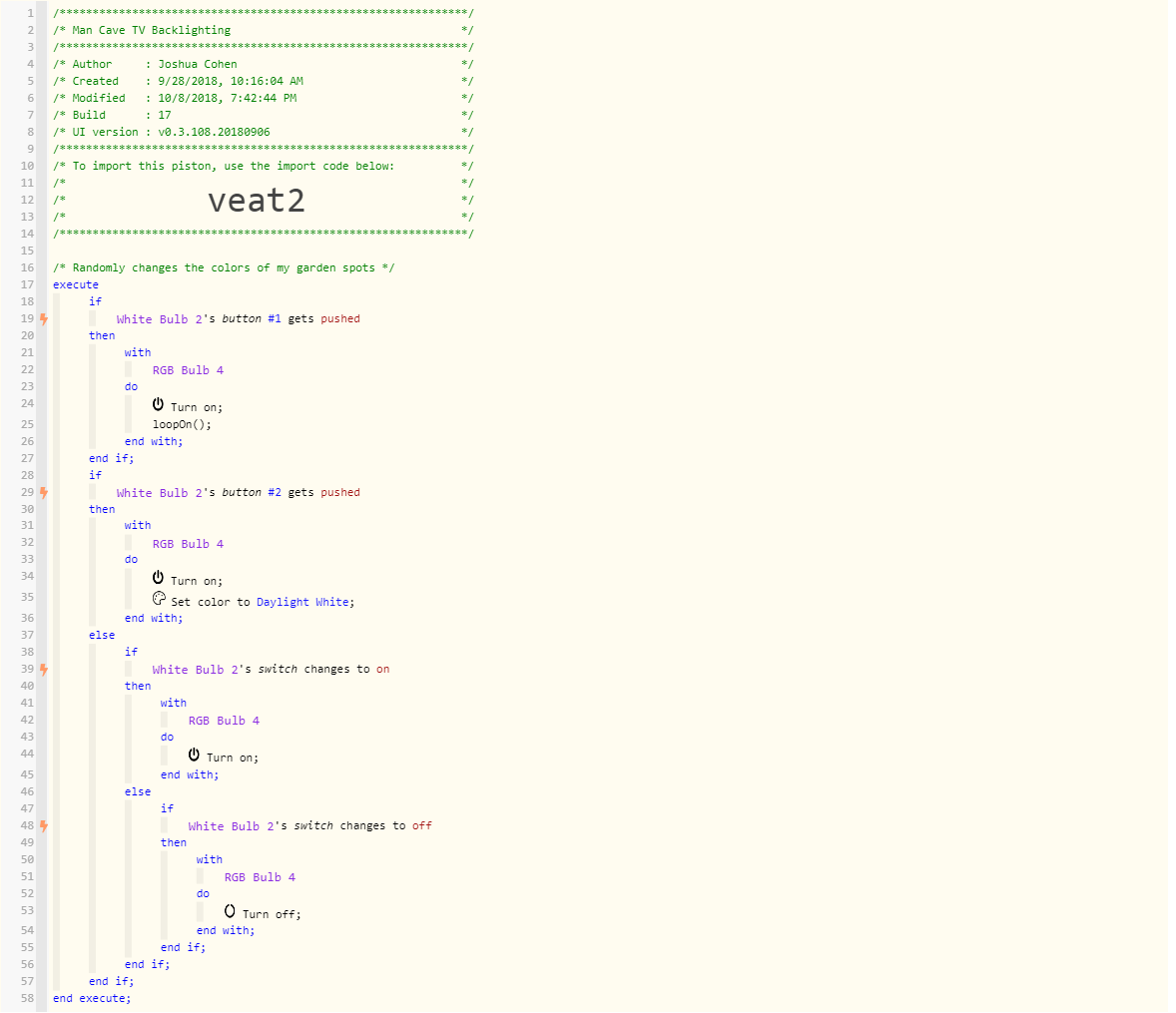

So I have this piston and it uses double tap to turn loop on and also doubletap to turn it to cool white but I have no way of turning it off on it’s own. Is there a creative way to do this?

Does your device report the double tap each time? If it does, maybe you can have a variable keep track of the number of double taps.
i’m not sure, it’s a GE zwave+ on/off switch
I took a quick look at the dth you’re using and it looks you get two double taps, one for up (button #1) and one for down (button #2)?
yes, i intend on using down to turn off the light
