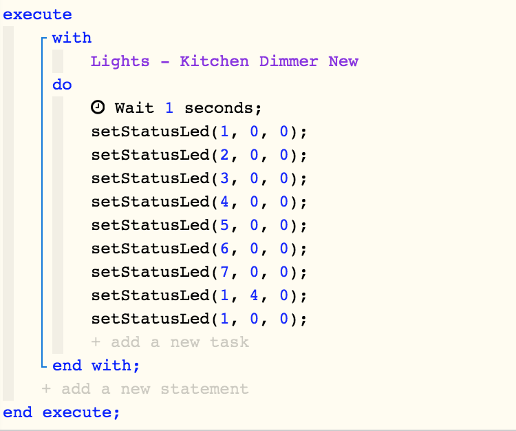

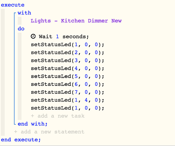

So, I set all LEDs for no color and to not blink by doing this:
SetStatusLed(1, 0, 0)
SetStatusLed(2, 0, 0)
SetStatusLed(3, 0, 0)
SetStatusLed(4, 0, 0)
SetStatusLed(5, 0, 0)
SetStatusLed(6, 0, 0)
SetStatusLed(7, 0, 0)
Then I set I set the following
SetStatusLed(1, 1, 0)
This should set the first LED to Red and to tell it to not blink.
Again, the expected behavior is to set the first LED to Red and to not blink.

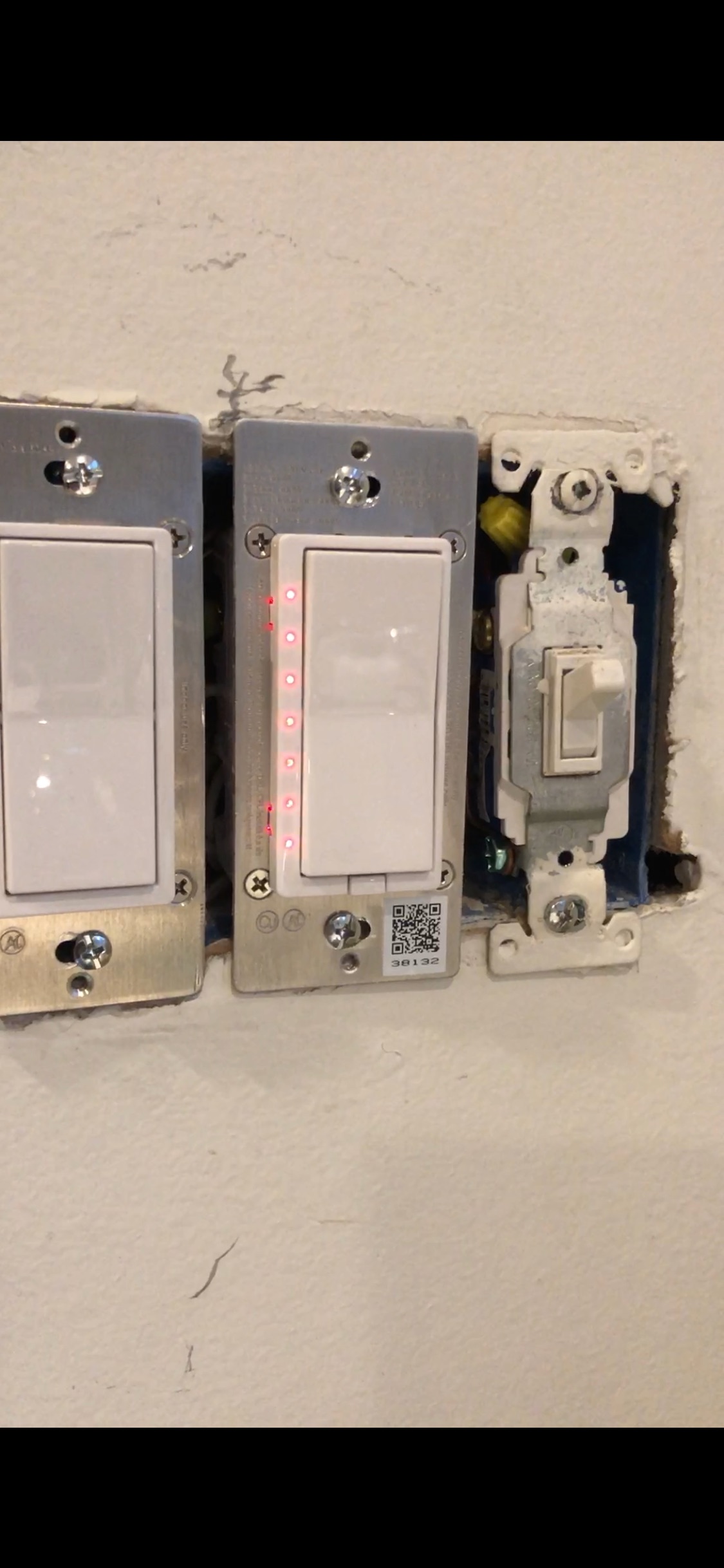

What happens is ALL the LEDs turn on to the color red. This is definitely not what I was expecting. I feel like there is a cache somewhere that’s not getting cleared. However, I’m not a programmer nor am I good enough to understand what’s really happening. Attached is a screenshot showing all LEDs the color red.
