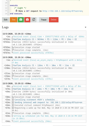

I have many (wifi) switches Shelly that I manage with my pistons in ST.
One month ago I read there is the possibility to turn on/off the switches by web request and so I changed all my piston with the new instructions (you can see one example).
I was happy, because I removed switches from Shelly cloud and the speed of activation was better …
But sometimes I had strange behavior, piston did not start or if started did not perform all the instructions, semaphore very often; sometimes I had piston that repeated the instructions twice, but totally random …
Yesterday I removed all web request and I come back to the “classic” instruction tun on, turn off and is since yesterday that I have no problem, everything work well, very well.
It’s possible that all the web request made my system unstable ?

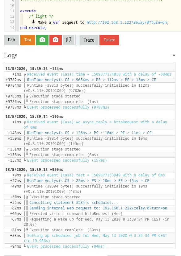

This is the log of this simple test (only turn-on the light by web request)
What am I doing wrong ?
From the logs, it looks like it took a full second for the response to come back.
15:39:13 = Press Test
15:39:14 = Response came back
15:39:33 = Recovery after 20 seconds (no action took place)
Ok, thank you …
