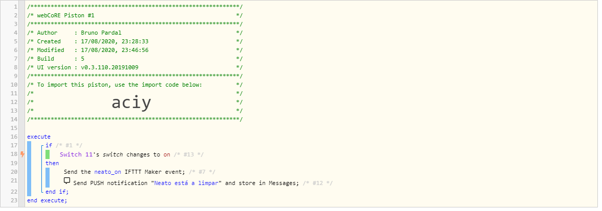

This just don´t work. Webcore piston is working well cause i receive the push notification in my mobile but the Ifttt maker event dont trigger. My IFTTT integration is OK. The name of the event is correct in the IFTTT website also.
To work and trigger the IFTTT event maker
Nothing
17/08/2020, 23:55:30 +135ms
+1ms ╔Received event [Focos Office].switch = on with a delay of 139ms
+145ms ║RunTime Analysis CS > 21ms > PS > 106ms > PE > 18ms > CE
+147ms ║Runtime (41558 bytes) successfully initialized in 106ms (v0.3.110.20191009) (145ms)
+156ms ║║Comparison (enum) on changes_to (string) on = true (0ms)
+157ms ║║Cancelling condition #13’s schedules…
+158ms ║║Condition #13 evaluated true (6ms)
+159ms ║║Cancelling condition #1’s schedules…
+160ms ║║Condition group #1 evaluated true (state changed) (8ms)
+162ms ║║Cancelling statement #6’s schedules…
+287ms ║║Executed virtual command iftttMaker (122ms)
+290ms ║║Cancelling statement #11’s schedules…
+310ms ║║Executed virtual command sendPushNotification (17ms)
+313ms ║╚Execution stage complete. (164ms)
+314ms ╚Event processed successfully (313ms)
