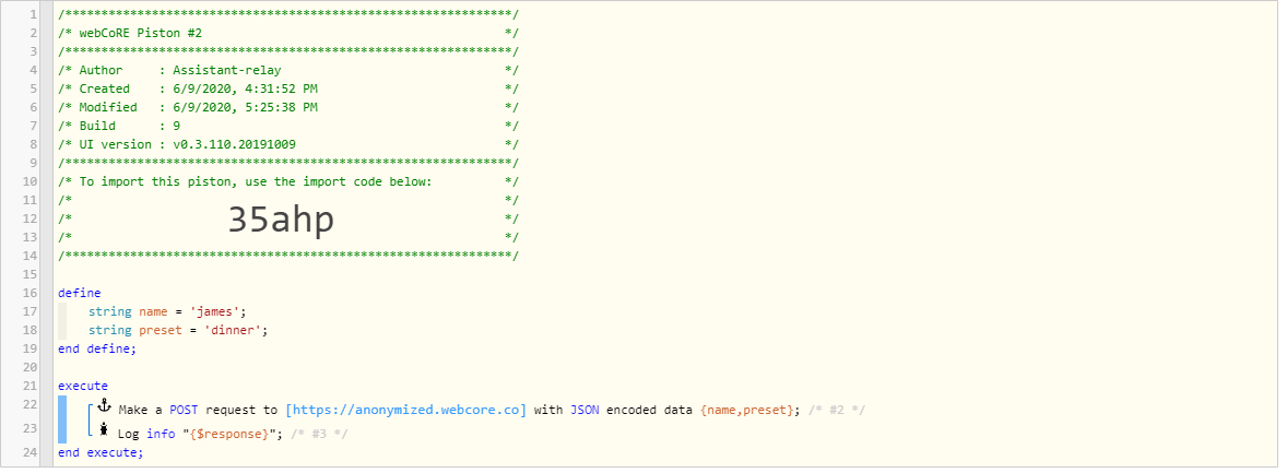

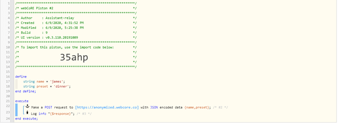

Web POST requests are not working from WebCore.
I’m trying to setup the Google Assistant Relay, which is working great for everything except WebCore.
I’m sure this is something very obvious, but since I’m new to WebCore I’m not sure what I’m doing wrong.
Nothing seems to be processed via my REST API.
I can do a simple curl from another box, and it works as expected. So I know Assistant Relay is up and running.
i.e.
curl -d 'name=james&preset=dinner' http://xxx.xxx.xxx.xxx:3000/assistant
{"response":"","audio":"/server/audio?v=1591739823747","success":true}
This causes logs on my Relay, and my google home speakers play the test.
But when I test the piston, nothing fires.
I’ve tried both the json and form options
