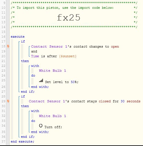

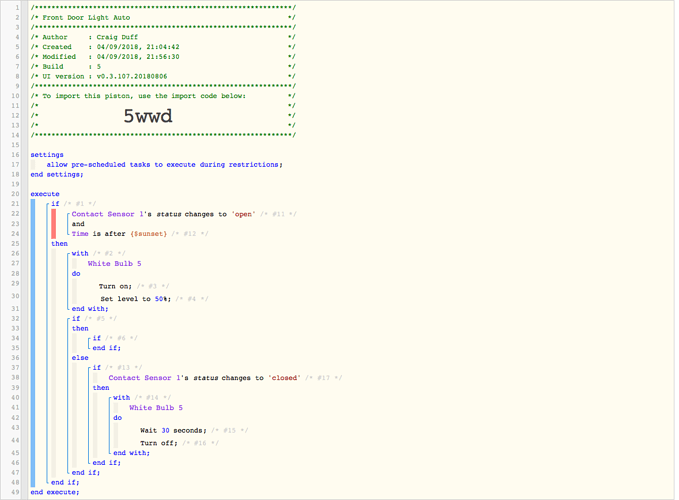

I am having issues with the wait command. It doesn’t seem to trigger as planned.
After sunset, when the front door is opened, the front door light activates. Then when door is shut, it waits 30 secs then turns off.
Light activating as planned, but not switching off.
(UPLOAD YOUR IMAGE HERE)
Sorry complete Webcore newbie and computer luddite so probably making some glaring mistake. I have read up on some similar issues on forum but to be honest seem well out my depth! Any clues as to where I am going wrong, and any suggestions for some basic webcore reading to get up to speed would be much appreciated.
I have managed to programme up basic pistons for auto lighting around the house which are working, but this wait command has me stumped. Many thanks
