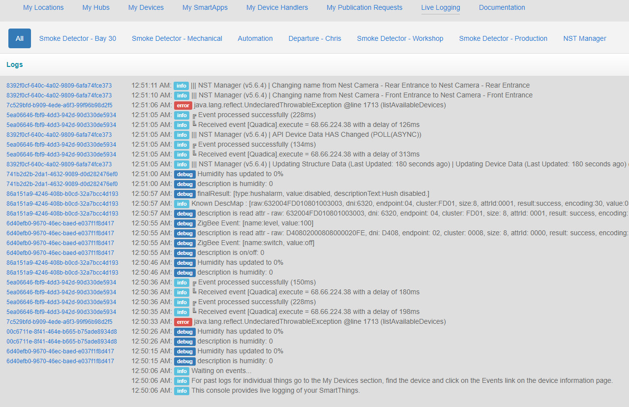

Is anyone else experiencing problems with WebCore? I am no longer seeing any pistons on my desktop and while I can see pistons in the app, I get the following message when Webcore is loaded, “There was a problem loading the dashboard data. The data shown below may be outdated; please log out if this problem persists.”
The location name is also missing. Instead all I see is “getLocationMode()}”. Tried the Cleanup and rebuild data cache function, but just get a message saying that “Something’s wrong”.
I installed the new Webcore smartapp releases earlier today and since then I have not been able to get Webcore to work.
The Live Logging is showing the following Javascript error, “12:50:33 AM: error java.lang.reflect.UndeclaredThrowableException @line 1713 (listAvailableDevices)” (See screenshot), so that would seem to be related somehow.

I rolled back the last Webcore updates from Github to the previous version of files (v0.3.10c.20190522), and that solved the problem.
So it would appear that there is a bug of some sort in the latest release.
Logs please, @Nezmo. Since no one reported that the workaround earlier this year from ady had fixed the UndeclaredThrowableException and tons of people were complaining about both that exception and the fact that the workaround caused the piston page to show NaN for device attributes, the workaround was reverted.
@warrisr please take some time to confirm whether this is failing for you 100% of the time on the new version of the smart apps and that rolling back fixes it 100% of the time. The UndeclaredThrowableException is very spotty for people with just a few too many devices since it depends on the load of the ST platform and whether it can load your devices quickly enough at the time you load the dashboard.
Seems we can’t win on this one; the ST Groovy platform is abandoned as far as scaling is concerned so the exceptions will continue to affect more people. If ady’s workaround fixes dashboard access for a few people I guess that gives them a bit more time to find a home automation platform that will work for their needs.
Definitely 100% failure rate with the 3.10d code. Tried it on several different devices over 24 hours and always had the same results. I just did the rollback to 3.10c about 2 hours ago and have only tested on one computer, but so far the problem has not re-surfaced.
I have 111 devices in one Webcore account and 22 in another. 3.10d would not work in either.

I am seeing the same issue as above in the logs when trying to access a piston:
1:25:41 PM: error java.lang.reflect.UndeclaredThrowableException @line 1713 (listAvailableDevices)
I am seeing an issue editing current pistons, the progress wheel just keeps going…
