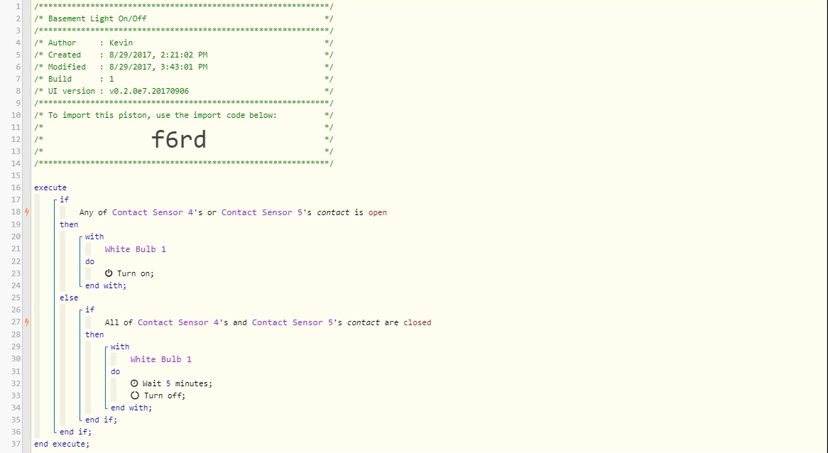

Anyone notice a longer delay with webCoRE. I recently switched over to webCoRE from Core and I have a lighting piston that turns on the basement lights when either 1 of two doors is opened. With Core it would come on basically instantly, but now with webCoRE there is a 2 second delay.

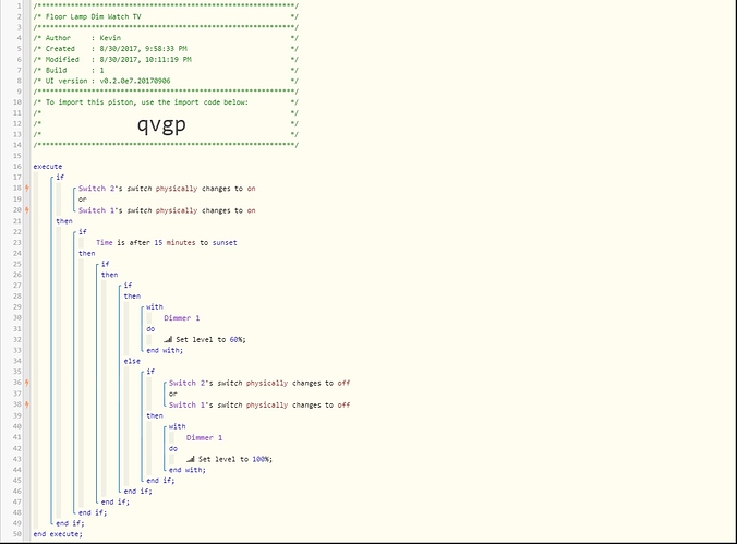

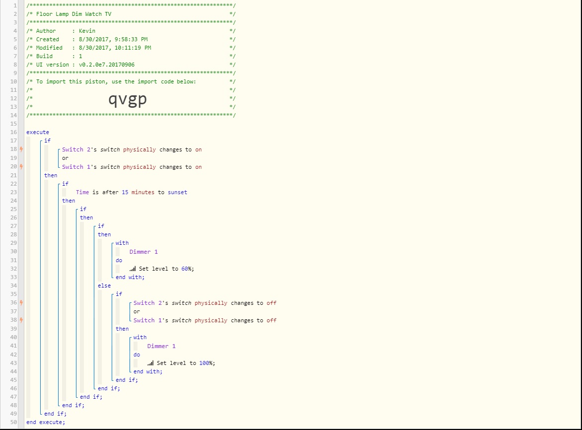

I also setup a new piston that I did not have on Core. This piston dims a connected bulb when the TV is turned on after sunset, but I have noticed this can be delayed up to a minute if not longer.

Basement Lights
TV
Basement light piston looks fine.
TV piston is all wrong…
You have a stack of empty IF/THEN blocks, each one introducing execution time.
You have a trigger inside a trigger… triggers need to be top level only.
Yeah I noticed that in there after just taking the snap shot. Not sure why it was like that. I will remove those entries and try it again later tonight.
Note: Any idea why the basement lights have a slightly longer delay? I mean its not too bad, but they used to come on instantly.
Maybe ST is having a bad day… webCoRE is far more efficient than CoRE and once you save a piston it’s saved to ST not the webCoRE servers, so it’s not introducing any additional hops.
